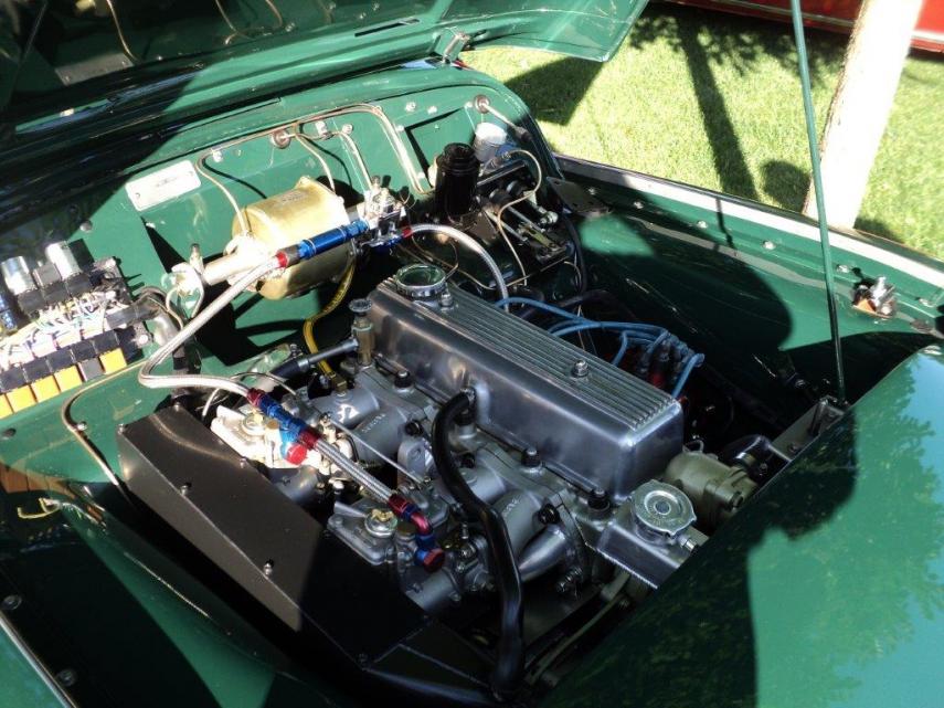

I belong to a car club that meets once a month for dinner. We bring our cars and park them on the grass outside. Tonight, there was a green TR3 parked with the hood raised and when I looked at the engine compartment, I couldn't believe my eyes. He had twin Webers with a black plenum chamber, a copper or bronze power brake booster where the battery usually resides with dual master cylinders, a huge distributor with electronic ignition, electric fan and everything immaculate - you could eat off the firewall. I questioned the owner - a vet named Kevin - and he told me he had installed rack & pinion steering from (I think) a TR4A. There was a custom grille with a yellow surround like the LeMans Tr3s and different seats. I didn't have a camera but another member was taking pictures and I asked him to email me a picture. If he does, I'll try and post it here. I never saw a TR3 like it. We had a concours for original cars before dinner and the winner was a 1936 Hotchkiss sedan. Other cars included a 1935 Packard, a 1950 Packard, a 1936 four-door Dodge convertible hot rod, two XK 140s, a 1962 Porsche, a brand-new Boxster, a Bentley, my TR6, a Cobra replica, a wartime Jeep, an Aston martin, 3 Ferraris, an Edsel convertible with only 15K miles...missing were another TR3, my friend's 1931 Model A, an immaculate MGA and a Morris Minor station wagon, all usually seen there. It was a beautiful clear night after three days of thunderstorms.
CJD
Cool! So, like, where did he find room to move the battery? Interesting brake servo set up...must take a serious alternator to power all those relays.
P
pdplot
Battery was placed in the trunk. Owner is a vet and likes to do his own work. I think he has a few other cars. I'll try to find out more of what he did at the next meeting.

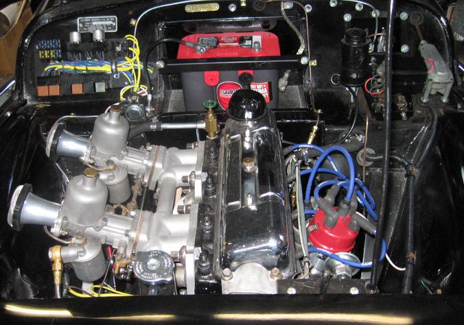

I have the same system in my TR3. Most of the switch functions are taken up by relays so you only have low currents going through them and thus leaving all the higher current duties to the contacts in the relays. Of course, there are extra relays for for things like electric fans and electric fuel pumps.
