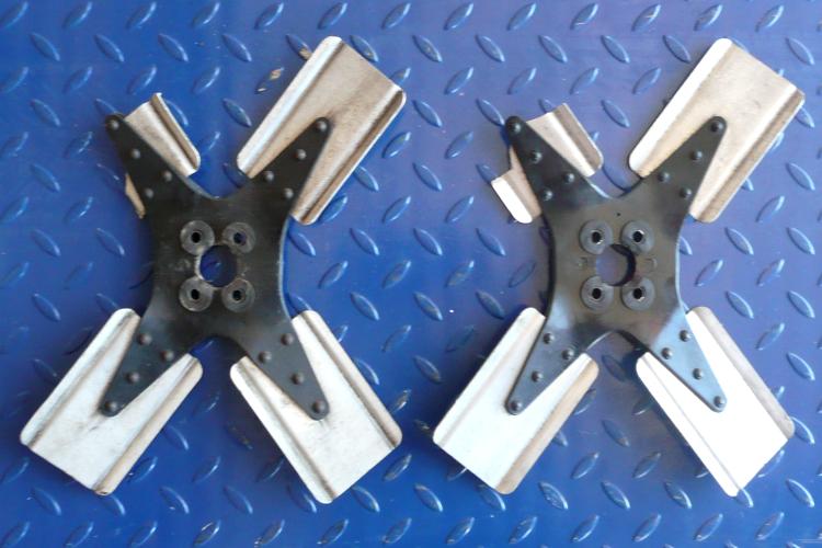

So in a box I have a tropical fan. It is not in perfect shape, but a little aluminum welding it would be good. I am thinking it would need to be balanced after cleanup.....anyone know of a company that would do that??
CJD
I don't, but I think if you just find a rod to fit the center hole and a level edge, you can balance it yourself. Allow the fan to roll until the heavy side is down, and remove a bit of metal from that side. Just keep repeating until the fan can be placed at any attitude and it stays without rolling.
Also work to match the pitch on the blades to be as close to possible to one another.
sp53
I think balancing would be good, but probably not mandatory; they bolt on the crank. I would use JB weld if the aluminum is oxidized with some small pin holes or something mostly because I am not a skilled welder. I have tropical fan that had some pin holes and rotted edges in the aluminum and that is how I fixed it with the JB and sandpaper basically built up a little material with JB. It looked to me that the metal was aged and feathered and welding would go up in smoke, but again you need a quality welder’s opinion. Maybe post a picture because I am curious also on the repair. Plus the aluminum they are made out of seems so soft.

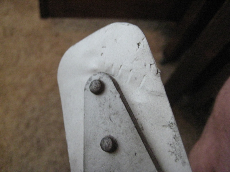

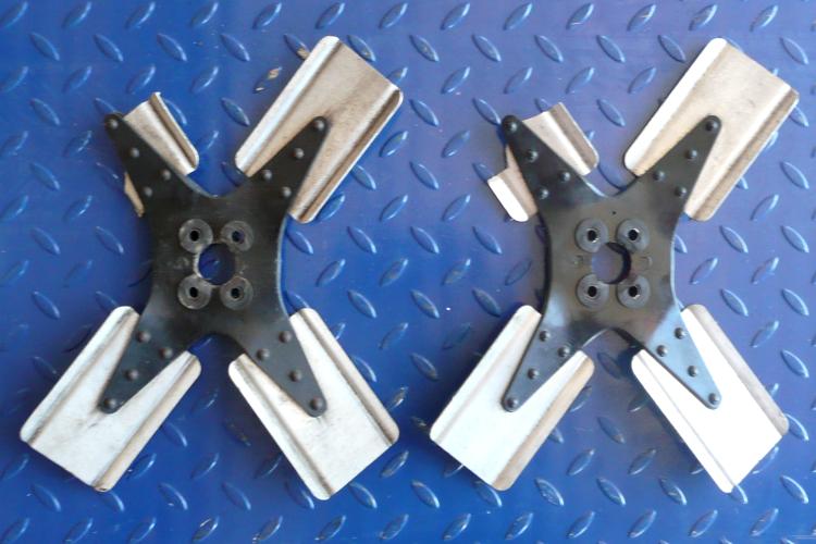

I've had two fans fail before I finally installed the tropical:
The tropical doesn't have as much aluminum extending out beyond the steel cruciform so a repair should not be as stressed - but I would be nonetheless concerned about it.

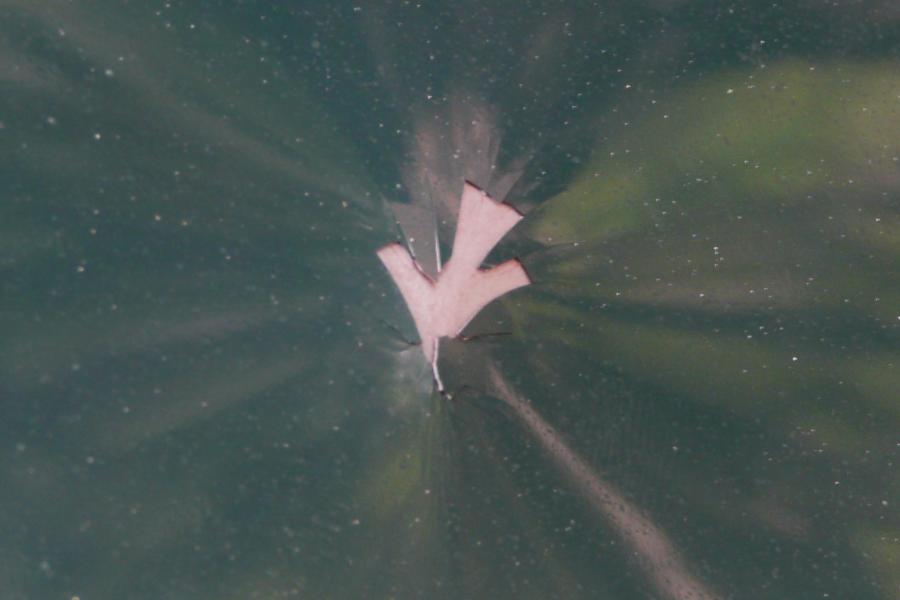

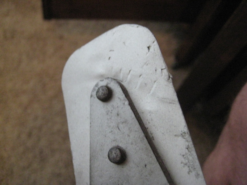

A departing fan blade can be troublesome. If they head down they just cut wires and hoses, but if they go up...

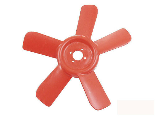

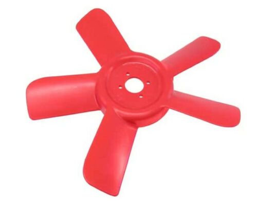

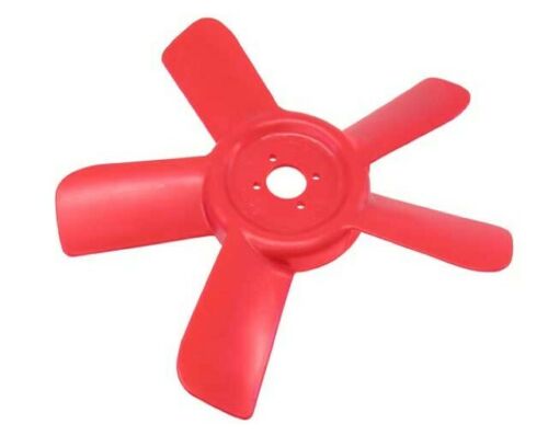

You can use the red 5 bladed non metal fan from the BMW 2002 series.The center hub holes are even in the correct place. I believe the fan from a Volvo 122S will fit as well. Use anything but the stock fan as it was designed for use in Jolly Olde Engand☔ weather.🙂
mctriumph
13 blades is MUCH better than5.But look at the cost of a BMW part compared to a nice used (often free)
tr7 fan.

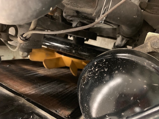

Sod off with that German BS, here is the Tr7 fan installed. I a Tr3. As with all fans it requires some rotation.....
karls59tr
Bronze
It was Randall that recommended using the Volvo 122 fan for better cooling. Would you tell him to sod off with his Swedish BS? To each his own.:smile:
Geo Hahn
Is it the photo or are the blades not all spaced equally?
The photo is an accurate depiction... a strange but balanced arrangement. Here's a more straight-on view:
Look for 3 'Y's in the scheme and you may begin to see why it works.
