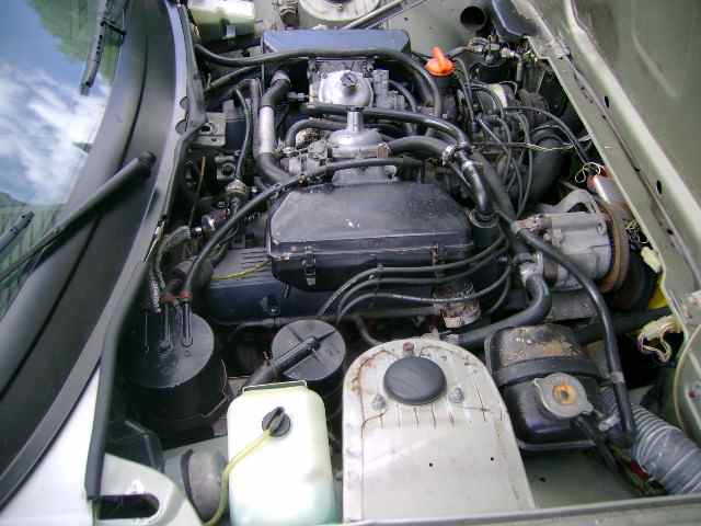

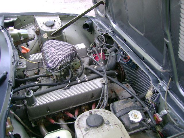

You can work on this

Well, I don't have any big mods in my immediate plans. My engine is dead stock, except that I did remove the air cleaner box and hoses and go with a conical K&B filter (mostly because I was having a hard time finding the filter for the original box, but it does make a bunch of room on that corner of the engine bay). Benefits of getting a car from a state with strict smog inspections!
In particular I want to keep the A/C, not so much for summer, but for winter demisting. That is probably the biggest obstacle to getting to the clamp.
But the good news is that either the bit my son was able to turn it, or the stop leak is working. I also put (another) new radiator cap on, and took a drive at lunch, and everything seems to be working as it should. And I hit 500 miles that I've put on the car now.
