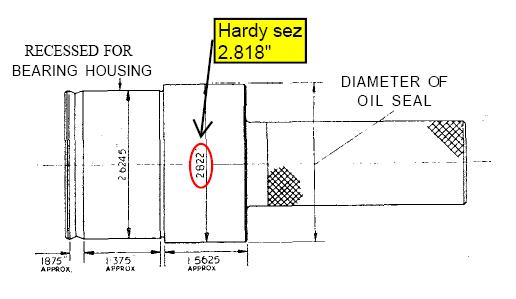

Indeed, the rear seal frequently gets reused, because it isn't <span style="font-weight: bold">supposed</span> to wear (being non-contact) and any wear present is generally not visible to the naked eye.
But another problem that can affect even new seals: the seal is not a simple bolt-on affair but needs to be aligned using a purpose-made mandrel. And the general consensus seems to be that there is a mistake in the original factory drawing for the mandrel, which leaves an extra .002" for the oil to leak through! That is why the "Viton" kit includes a new mandrel, which is made to the "correct" smaller size.
