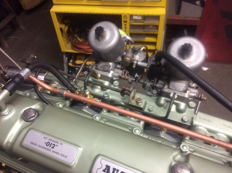

A PCV setup will cut the leakage down considerably. My engine builder outdid himself, and my BJ8's engine hasn't leaked a drop in over 5K miles (the gearbox and OD are another story however):

Congratulations, Bob. Wish I could say the same. My leaks were much better before the rebuild.

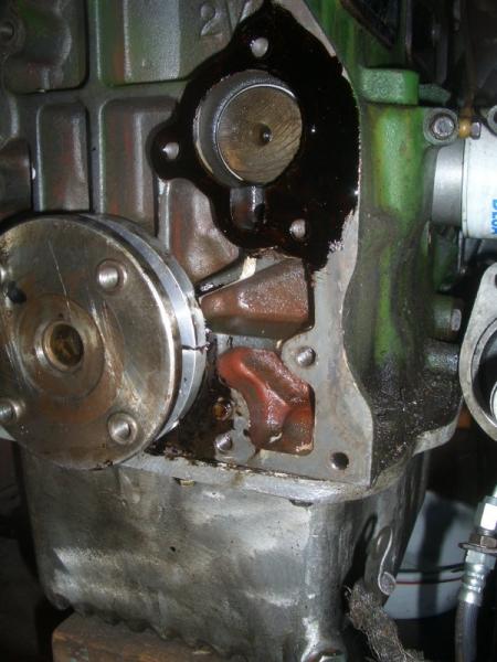

Depending on where they are located, serious stopping of the leaks can be a major program involving removal of the radiator, transmission, starter, engine rear plate and flywheel. Jack up the front of the engine; seal the front engine cover and plate. Seal the rear plate to the engine, especially around the cam bearing hole. Seal the rear seal carrier to the block. Seal the vertical joints of the rear main bearing. Carefully fit and seal/install the cork pieces around the rear main, as well as the pan gasket. Use hylomar on the pan gasket. Do not over-tighten pan bolts. It goes on and on.
I like Aviation Form A Gasket and Hylomar.
Sometimes it's hard to tell whether the engine or transmission is the one leaking if the leaks are near the flywheel.
