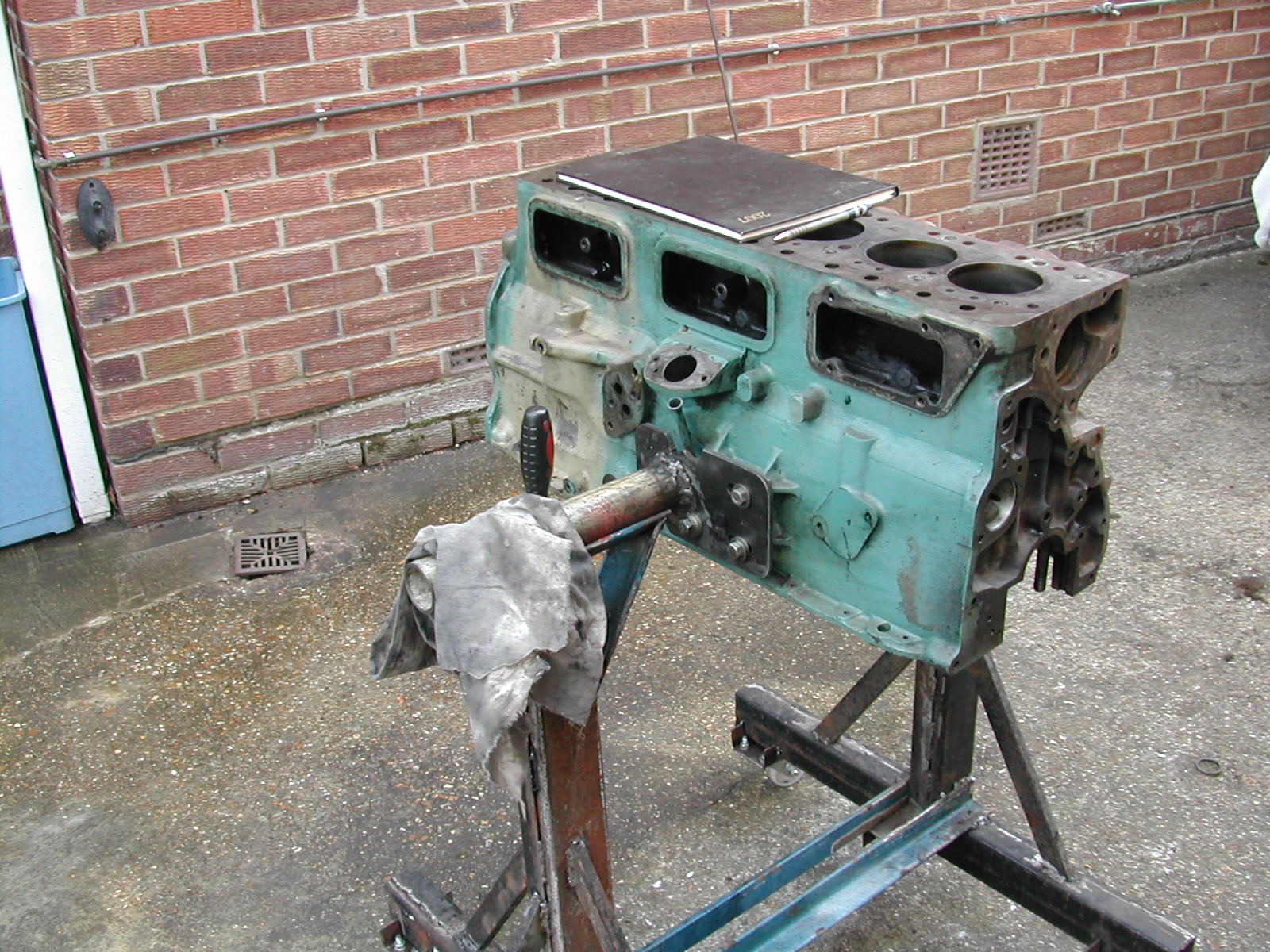

I cobbled this one from bits and pieces that I had in my steel stock, modifications would be bigger wheels next time.
The engine is locked into place by an old screwdriver, passing through the steel tube and into the frame.
