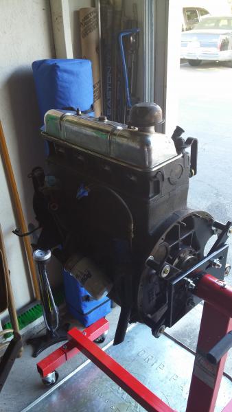

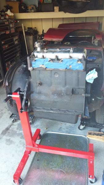

KVH....here is how I have mine mounted on a new HF tool stand. It does lean forward a little, but nothing too concerning since I'm going to be stripping it down which will relieve stress. I hope this helps.
First time I get to use the pic tool! HAHA

TuffTR250
I have seen people put a 2x4 under the front end of the engine down to that front cross piece of the stand (at the opposite end from the engine stand mounting). That helps support the front end and takes some of the stress off the back end of the stand. You may have to carefully measure and cut a 2x4 to get a good length.
