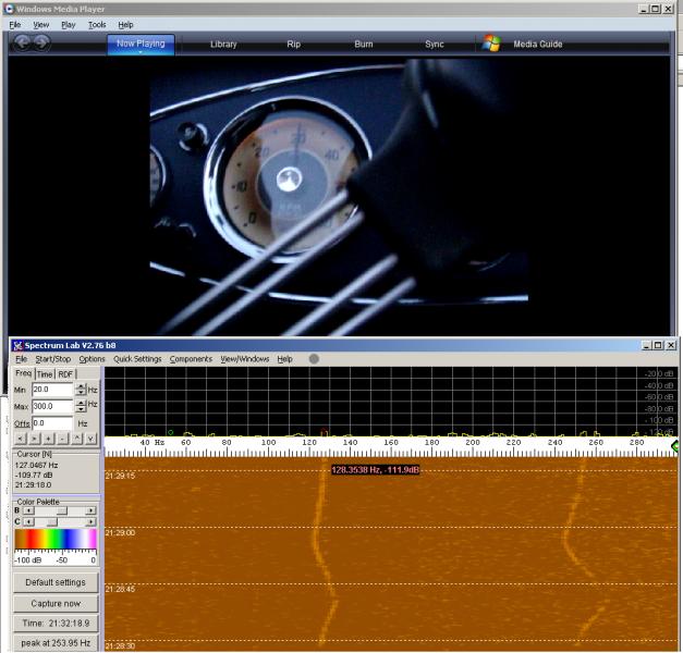

Hi Dave,
Here's something a bit random I was thinking of last night on the way home. I was wondering what the simplest way to check the tacho accuracy would be as I have for a while suspected mine is reading quite a bit high. For example, I can easily hit 6000rpm if I stand on the throttle and wait long enough (Longbridge engine).
Here's the trick. Take a video of your rev counter while driving at different speeds [edit]or parked in the garage. It doesn't need to be recorded on anything fancy, I used a Sony point-n-shoot still camera that has a basic video function and it worked very well.
Next step is to download the free Spectrum Lab audio analysis program which is very simple and easy to use.
Then play the video with Spectrum Lab open and it will 'listen' to the sound and pick out the predominant frequencies. The lowest frequency is the exhaust note and the engine speed is 20 * that (Hz * 60 for minutes, * 2 because four stroke / 6 cylinders = rpm) e.g. 138Hz * 20 = 2760 engine rpm.
Above is a screenshot of playing back the vid I made on the way back home. Engine rpm is 2560 so the tach reads 440rpm too high and it gets worse the higher the revs go.
In OD top with 3.54 diff and Michelin 180HR15 XAS tires (rolling diameter 25.83"), 2560rpm gives 71.5mph.
Andy.
