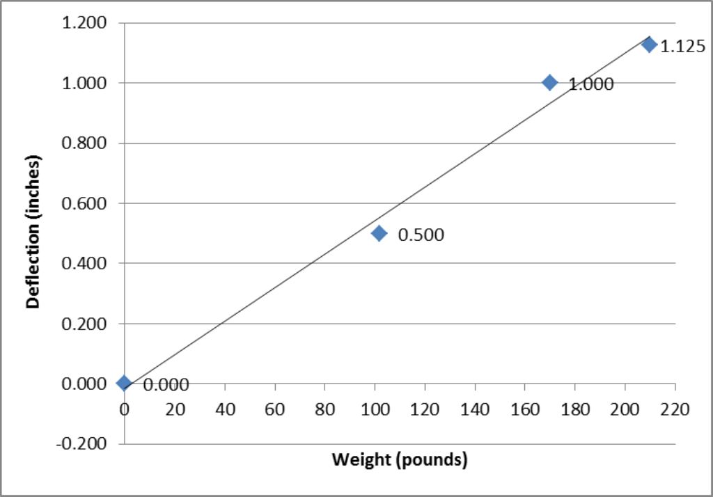

I think the rear springs on my Bugeye are weak with age because the car bottoms out on fairly mild bumps in the road. Since the available aftermarket springs apparently raise the rear end unless you remove some of the leafs, I'm reluctant to replace the springs unless I can determine that they really are worn out.
I took some measurements, put them into Excel, and made the plot shown below. (Click on the thumbnail to get the full size image.) Each measurement was taken by having someone sit directly over the rear wheel and then measure the change in the distance from the garage floor to the top edge of the wheel arch. The data looks pretty linear, which is what I would expect, but I'm wondering if the slope is the same as a good spring or not.
Would any of you with Bugeye's be willing to take a similar measurement and let me know the amount of deflection?

I've had the springs out to clean them and the spring boxes. There was almost no rust at all, so I think we can rule that out. The shocks were replaced a couple of years ago, but of course they still could have gone bad. I'm hoping that's the case, because there's a good fix for that and I really don't want the aftermarket springs if I don't need them.
I'll try the "two fingers" test, but it sounds like it might not be that accurate. 'Sure would appreciate anyone who is willing to take the deflection measurement described in my original post and let me know how yours compare.

I just tried the "two finger test". I could fit three (of my) fingers between the top of the tire and the top edge of the wheel arch. Actual distance was 2 and 3/8". What bothers me about this method is (1) my fingers are probably smaller than yours, (2) there was no mention of how full the gas tank should be (mine is about 3/4 full when I measured), and (3) there was no mention of tire or wheel size (I'm running 175/70x13's).

Would a more practical measurement be from the bump-stop platform on the axle to the platform on the arch directly above that point? (Take tire size and bump rubber wear out of the equation)
That would certainly be a better way to see if the springs are sagging with age.
