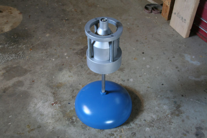

I posted this on another forum, but thought I would try here also. I am wondering if anybody has tried the Harbor Freight wheel bubble balancer? I am ordering a new set of 60 spoke chrome wheels for my TR3, and am Leary of having a tire dealer mount them. I am thinking of trying the HF tire mounting machine, and there bubble balancer. I cannot find anyone local that has the ability to correctly balance wire wheels, so thought this may be an option. Any thoughts?

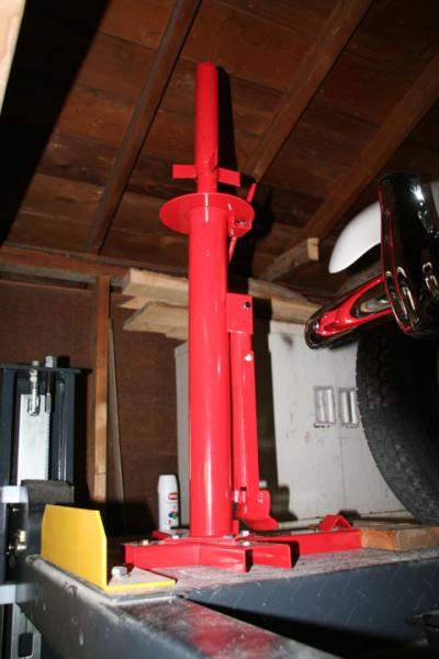

I mount and balance my own tires & wheels using the HF tire change and bubble balance. I'm slow but I get the job done and know it is right.
The tire changer works well once you get the hang of it, also helps to have one of their 24" tire irons on hand. For wire wheels I mount one of the adaptors to the HF changer to help secure the wheel. I always work with the backside of the wheel facing up so as to not mar the visible side of the rim.
Our tires have pretty tall sidewalls (e.g. 165/15s) so those are pretty easy to mount -- modern tires with low aspect ratios can be trickier.
The bubble gadget is simple non-dynamic balancing but I have never had a problem with the results using stick-on weights (HF has those too). Probably helps that modern tires are well balanced to start with.
The whole thing is easier if you have a lift as it can be used to mount the changer very securely. Also, I use the lift itself as a bead-breaker as the Harbor Freight bead-break attachment (that comes with the changer) can be a bit rough on the rim. Might not matter on your tires but I have some wires that I have sealed rather than use tubes and do not want anything scraping against those seals.

So I then purchsed the HF bubble balance and they were spot on.

New wires are on the way. I decided to try dismounting and mounting with a couple tire irons, if that doesn't work will buy a HF mounting machine. Also have decided to go with the HF bubble balancer. I will let you know how they work. Tires are new radials so breaking the bead shouldn't be to tough.

I really like the HF tire mount equipment except for the included bead breaker -- a bit too much effort, drama and violence for me. Instead I use one end of the lift though I think something similar can be done with another car, some boards and a jack.

I got a professional-quality Coats balancer on Ebay a couple years ago, and use it for everything. I don't think it cost much more than the HF one and the quality is vastly superior.

I installed my new wheels today. I used a HF mounting machine, and 2 HF 24" bars. Worked good. I mounted my HF machine on my lift, for stability same as Geo did, great idea. I was able to get a old bubble balancer from a friend that had used it in his gas station 30 years ago. Looks just like the HF model now. Took the car out for a test run, and was totally smooth up to 70 mph.
