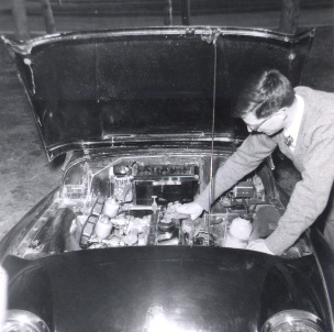

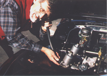

I have used the hose technique for 49 years. You want to use it like John describes. Loosen the tiny nuts and bolts where the two carbs are connected between them, They will be balanced when both carbs have the same HISSSSS. If they are not balanced, one will have a HISSSSS and the other will have WHOOOSH. I hold the lower end of the hose with my fingers so that the end of the hose touches the bare flange at the carb air inlet (throat) opening (after removing the air filters) then I quickly move the hose to the same spot on the other carb.
