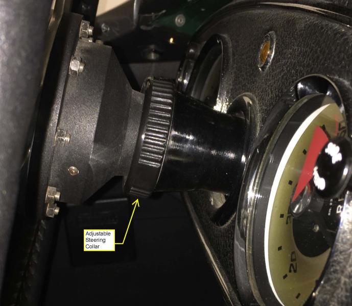

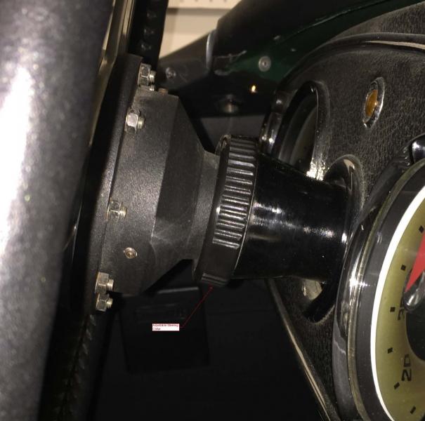

Here is a photo. If you have an adjustable steering column, you will see the collar (labeled, but sorry for the small print) behind the wheel.

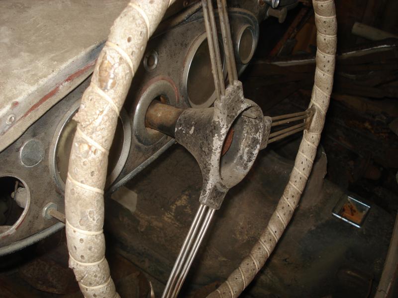

Yup, what John says. Here's a picture of a non-adjustable in case that is what you have, it will look like this. Only hopefully a little cleaner.

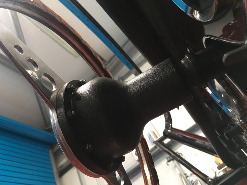

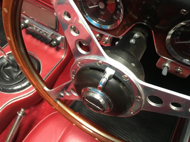

image.jpgimage.jpgThanks guys, I omitted to say it's not the original steering wheel, And as Steve has been helping me out it appears not to be a standard fitting. photos attached.
John Turney
Your trafficator (The piece with the turn signal lever and horn push) is the type that would be on an adjustable steering column. The steering wheel hub is an aftermarket one. So is mine, but mine is made to work with an adjustable column. You may be able to loosen the two clamp screws on your wheel hub and adjust the steering column some, but it doesn't look like you could adjust by much.
