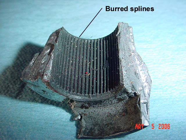

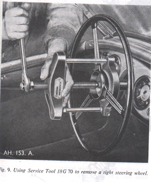

The bottom of the hub splines develops a burr which will not let the wheel come off. You can slide it up & down all day & not get past the burr. The factory shop manual shows a puller. The puller consists of a split "clamshell" that fits behind the wheel hub, some puller bolts, & a top section that bears on the end of the steering shaft.
Be careful about damaging the very thin wall section on the end of the shaft. I would machine a small stepped plug to fit down into the shaft bore for the puller to bear against. If you screw up the threads, you are in real trouble.
I was in a hurry to replace the wheel & just cut the hub into two pieces. Even then, it was hard to get the separated pieces off of the spline. When I finally got the hub off, the burrs were obvious. In retrospect, I would have taken whatever time needed to get or make a proper puller. A pic of the hub is attached.

A pic of the steering wheel puller is attached.

You guys are amazing! I used a puller and BINGO, the wheel came off. Thanks again to all of you for your expertise and response in this matter. I am very grateful. Pete

You are probably correct. The hub splines overhang the shaft splines when the hub is fully seated. Any slight working of the joint during use will likely raise this burr. At the time, I was so disgusted that I just put the new wheel on & forgot about it. Now, I'm not about to remove the turn signal assembly & wiring to get the wheel back off for modification. Maybe next time, if there IS a next time.
