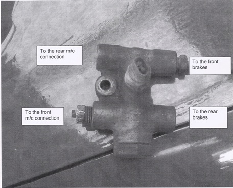

Is this the correct way to connect up a brake pressure balance valve on a 1970 TR6? scan brake press.a.jpg
thanks, Scott in CA

I believe so. The rear section of the MC feeds the front brakes.
BTW, that "valve" is known as a Pressure Differential Warning Actuator or PDWA for short. It isn't a valve at all, it never blocks or changes the flow of fluid. All it does is cause the switch to close when there is a large enough difference in pressure between front & rear brakes.
