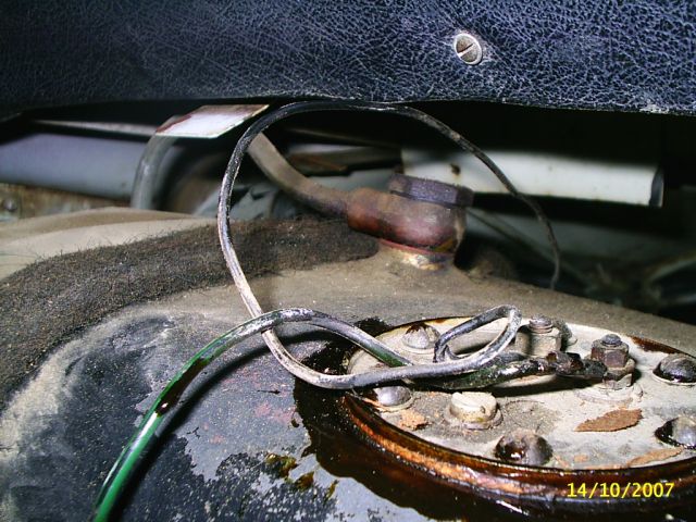

Does anyone have a better pic of the vent banjo assembly?
Thanks,
John
Jesus
Hello John,
Here is one photo of my TR3A as I bought it. I will look in my archives for a better one.
Jesús

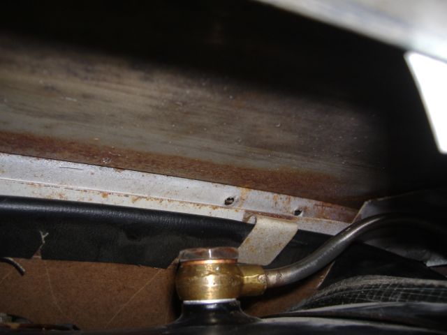

Jesus
Here is another picture of the banjo once refurbished.
Hope this helps.
Jesus
