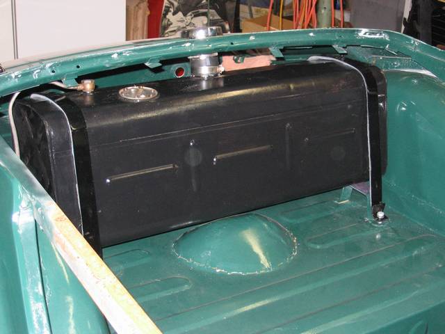

Here is the tank with the rubber straps

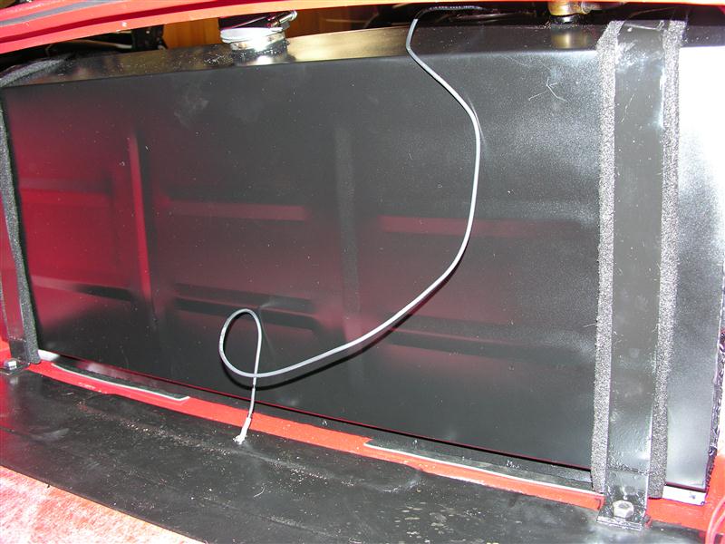

Here's a shot of mine with the early tank. The rubber pieces under the fuel tank are from MGB battery mount. I replicated the original felt on the straps by gluing together two layers of thinner black felt.

We are doing a 61 in the shop now ,we made 2 rubber 1/8 thick pads for the tank to sit on,glued to the brackets.Then used some scotch brite pads cut into strips to act as the felt on the straps (glued also).This seams to hold it very securely in place,and looks great though I doubt if it will ever be seen again....

Thanks all for your help and again a special thanks to Don and his photo. That is exactly what I need to see that the tank just caught the end of the bracket. For some reason, the idea that the tank only caught the end did not make any sense to me.
