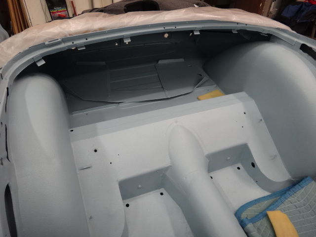

I may have just answered my own question. I found 6 metal tabs sticking out from the top back of the cockpit. I'm guesing that the upholstered mill board rests on those tabs? Is that correct? If so where do I go from there. Please remember that I did not take this apart. It may have been the PO ro my son. In any event it was 15 or 20 years ago.

The fit is certainly not rock solid but it gets a lot better once you cover the wheel wells and attach the dog leg trim and the cockpit capping pieces. Look for two sheet metal tabs below the capping in the back. Wedge the top of the millboard between the capping and the tabs and then push it back to fit over the wheel wells. I ended up attaching two small tabs at the bottom and used sheet metal screws through the sloping panel to keep everything in place. That made the whole assembly finally rock solid (sort of). If you have a post 60,000 body with a flat ledge, you may or may not need to use the tabs on the bottom.

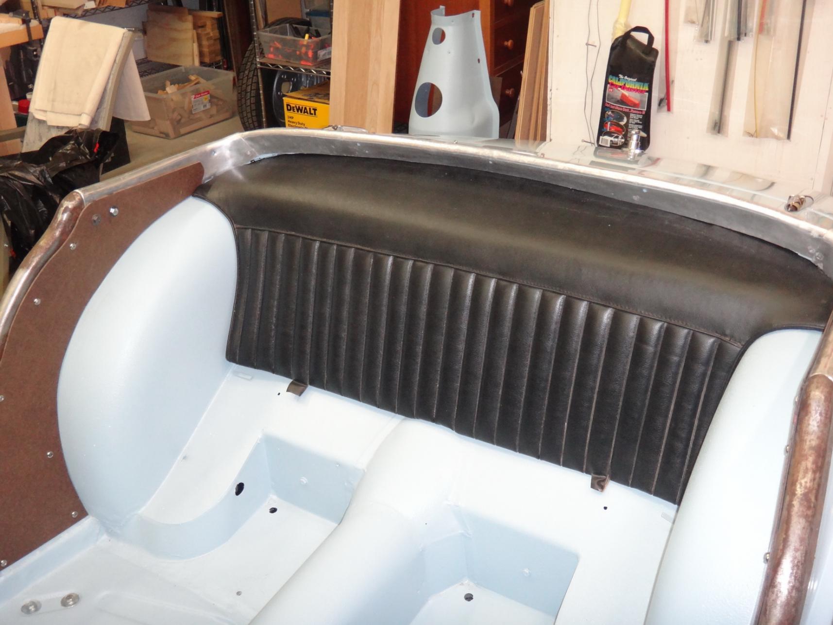

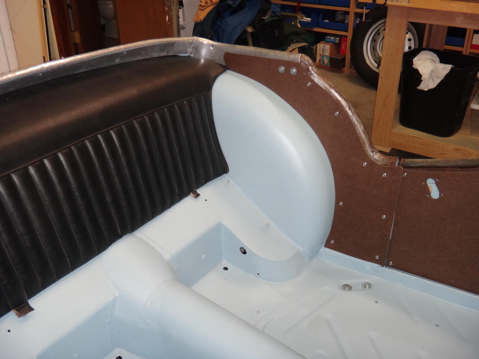

Does anyone have any pictures of that mil board fit?
I've been through the fitting stage recently and have several photos from different angles. I'll post a couple here as an example. If you want any from a different perspective, let me know where to send them. In one you can see the "clips" that the board fits into, and the other two show how it fits.
