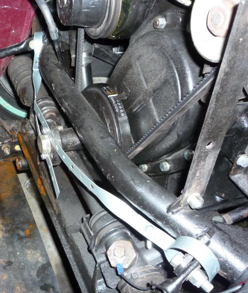

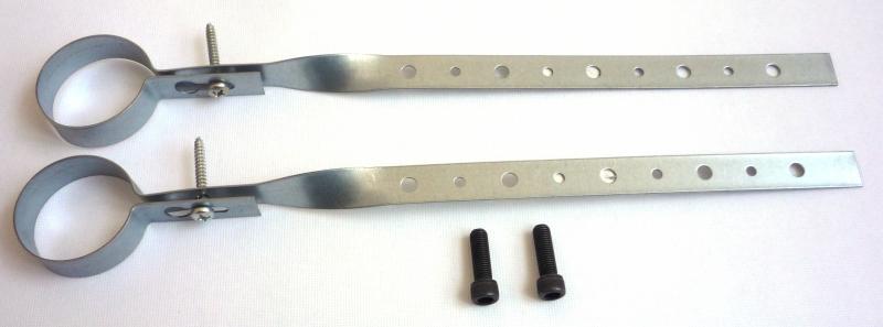

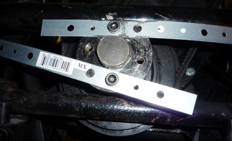

This is how I removed the crankshaft bolt on my TR6. I don't know what your engine looks like but you may be able to adapt this setup...
