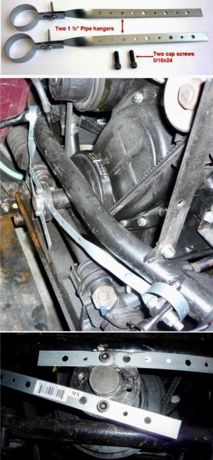

Gliderman8
This is how I tighten my crank bolt on my TR6.
Post in thread 'Front oil seal HELP with.....'
> Front oil seal HELP with..... <
