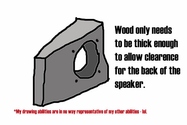

cut a wedge shape out of some wood, and use a slim speaker, and mount it on the side kickpanels angled back towards the passenger compartment (drivers side speaker angled toward passenger, pass side speaker angled toward driver). Cover the wood with some vinyl and you'll hardly ever see them. And in this postion, they'll sound a lot better than they ever did next to your hip.
See attachment.
