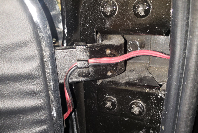

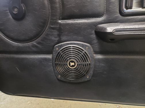

Our 1980 MGB LE has speakers in the doors. The speaker grill opening is about 4" diameter. Don't know what size the speakers are. The speaker wire exits the door through a hole with a grommet below the upper door hinge, goes across the door hinge, into the interior and runs along the square bar that runs across the car, behind the dash.
A photo of an original MGB LE interior in the current Moss MGB/MGC catalog shows the same speaker grills. Clausager's Original MGB book states (page 41) "The door-mounted loudspeakers seen here were fitted to American cars from June 1976, but on RHD cars only from the start of the 1979 model year."

The doors only allow 43mm clearance from the window mechanism: I found that a pair of RetroSoundĀ® R-652N 6.5" speakers rated at 100W went in a treat, with a little dexterous hacking of the door card. The speaker cables I have attached with black zip-ties across the top of the hinges – looks neat enough for me.

Further to speaker location, my door cards had a perforated circle of 4" / 10cm diameter pre-cut at the correct position below the window winder handle: so my first attempt was easy. Cutting the vinyl was okay provided I left triangular flaps to poke through and glue behind. When I upgraded to 6.5" / 16cm, which is well worth doing, the cutting was more demanding but just needed patience to size it right. But, as I say, not many speakers meet the 43mm clearance requirement.
