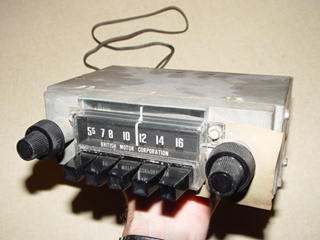

The most common "original equipment" radio was the British Motor Corporation AM radio that was also supplied with other cars in the 1960s. I just happen to have a nice example handy here, so I'll (try to) include an image.
You can occasionally find these available on eBay, although they are somewhat unusual (I would not quite say "rare"). However, this is a very basic AM-only radio. Those who are very concerned about originality seek these, but those who want to listen to FM and/or play cassette tapes must do something else.

OH Oh Reid, Do you also happen to have a picture of that pityful little oblong speaker that was used with this radio and fits behind the speaker screen for SHG---Keoke /ubbthreads/images/graemlins/smile.gif
