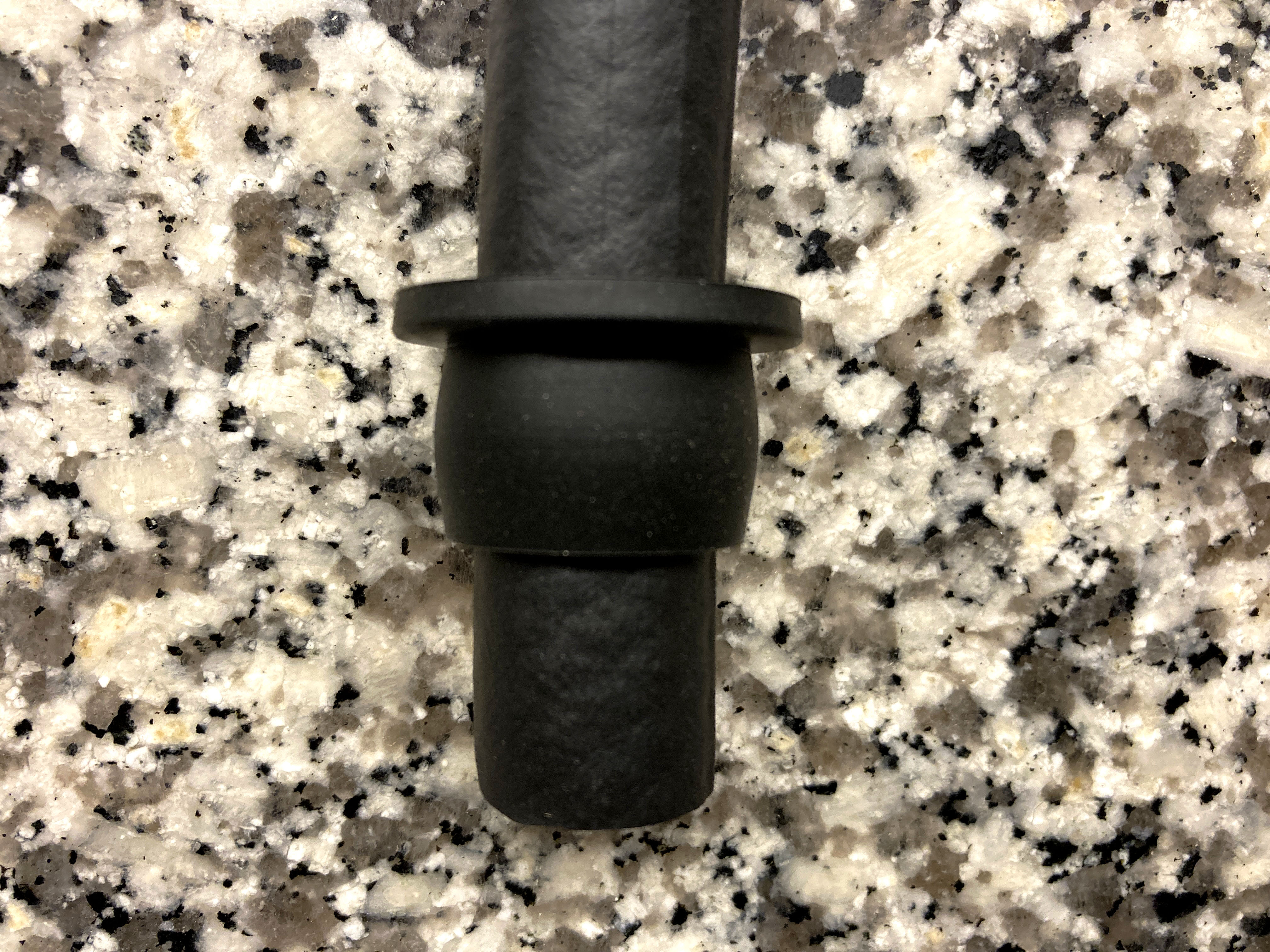

The first picture is the Moss drain tube grommet.

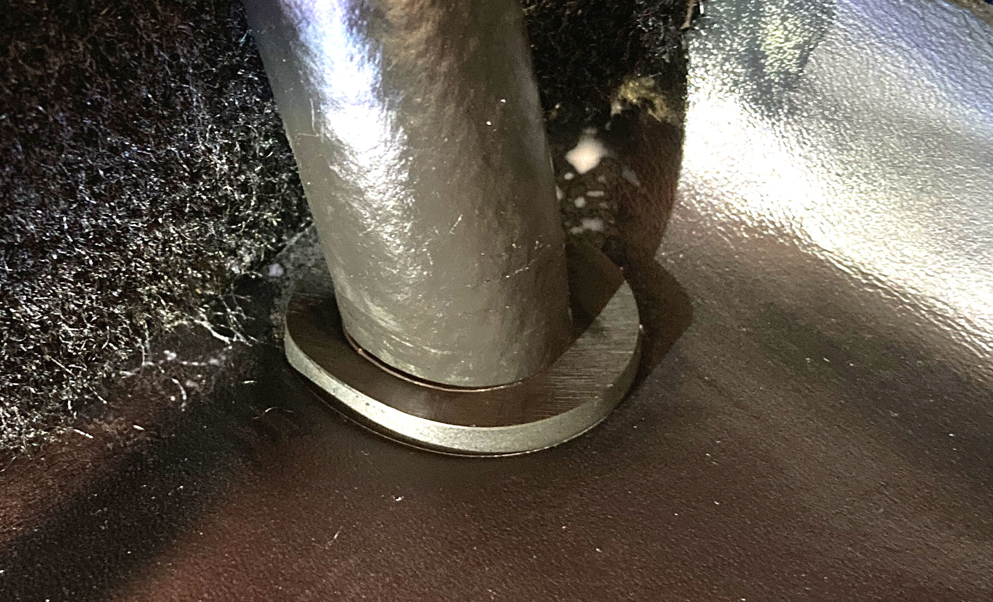

The second picture shows the tophat grommet after installing a rubber tube. Unfortunately, I had already installed the drain tubes on our BJ8 before deciding to take a picture. The only rubber tube I had available was smaller diameter than the BJ8 drain tube and it does not expand the grommet diameter as much as the BJ8 rubber drain tube.

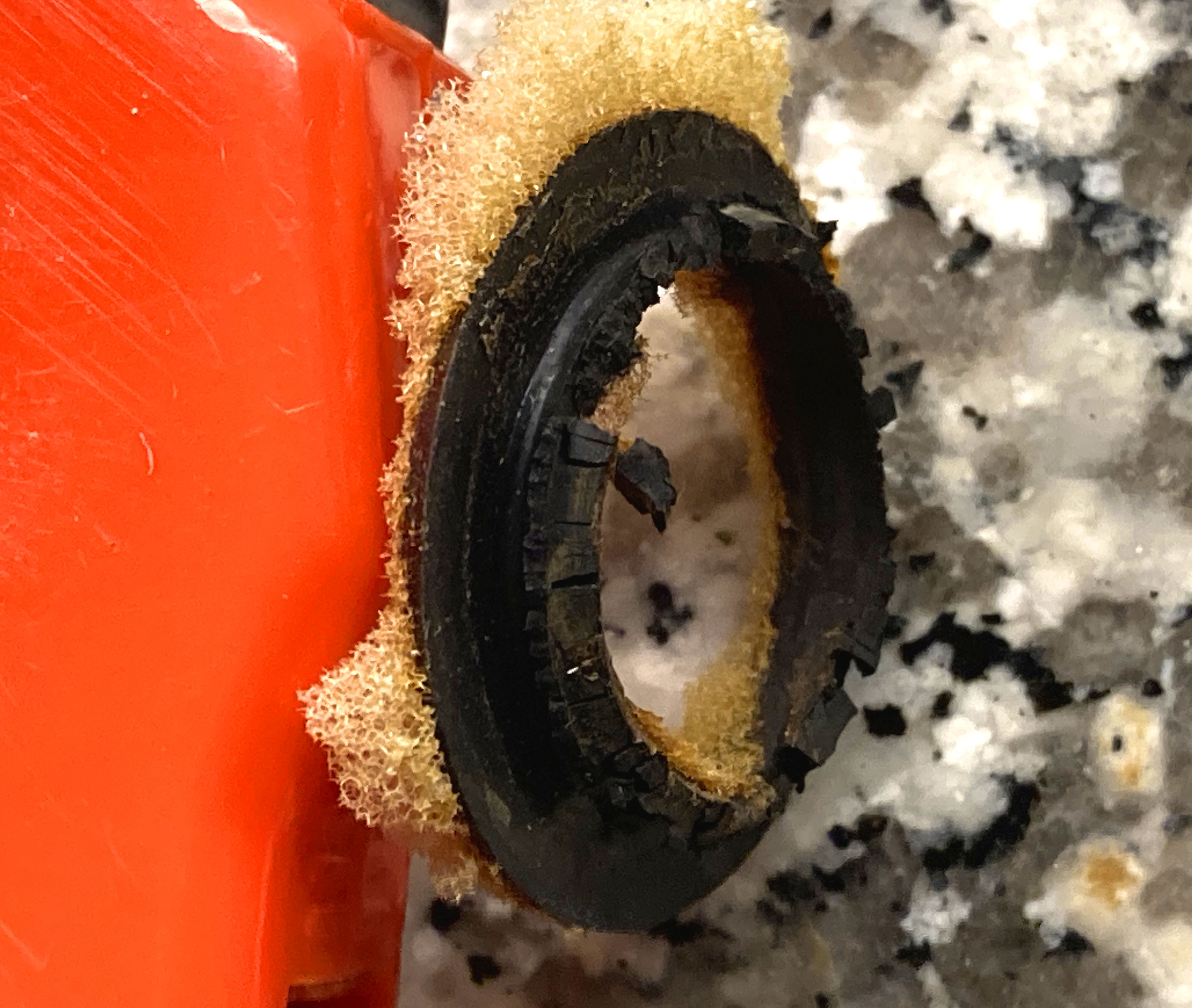

The third picture shows the tophat grommet installed with the correct BJ8 rubber drain tube (I wiped it down with leather dressing to remove most of the chalk dust from marking the carpet :smile:).

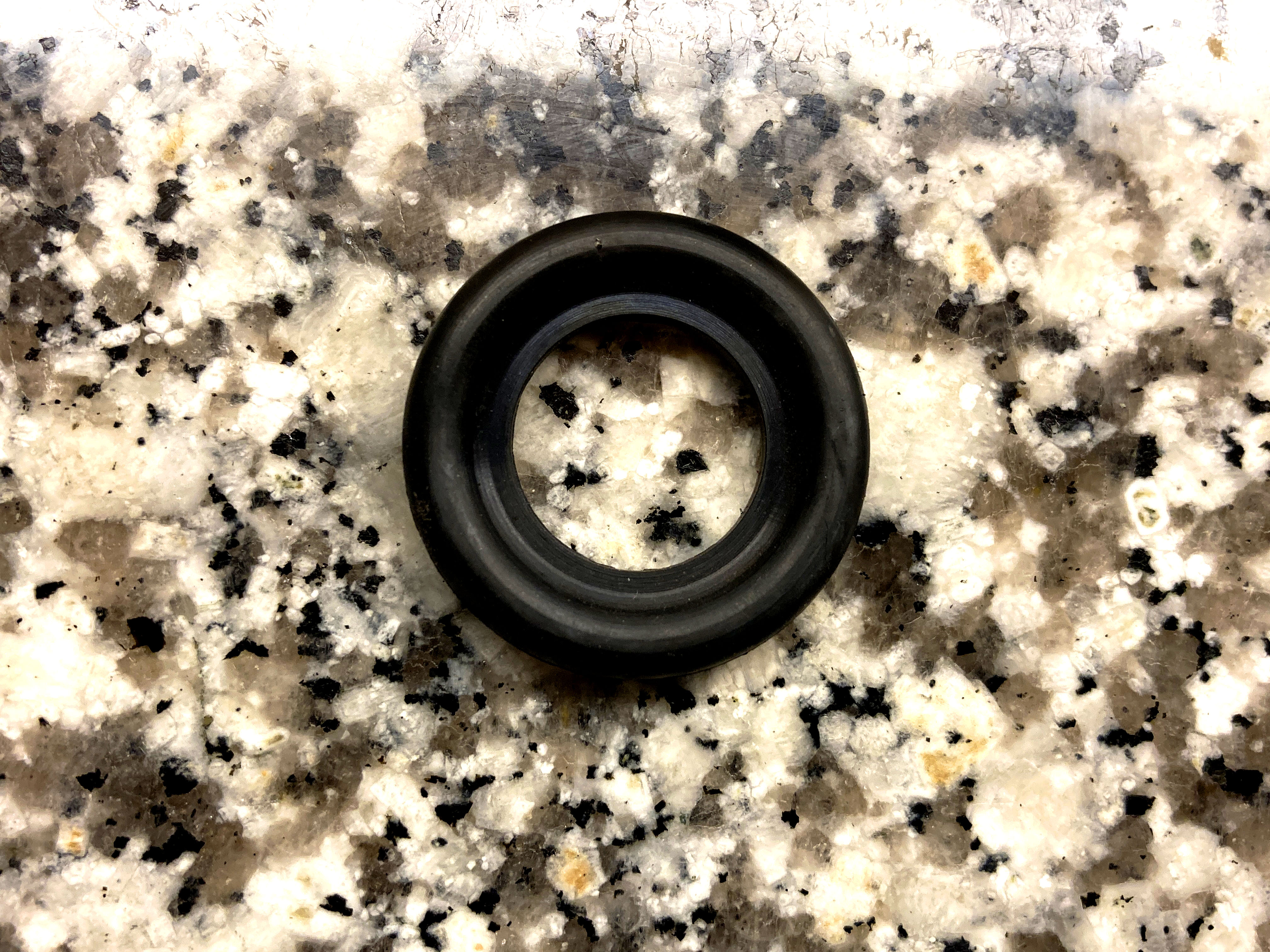

The last picture shows the condition of the poor quality stock drain tube grommet after a few years.
