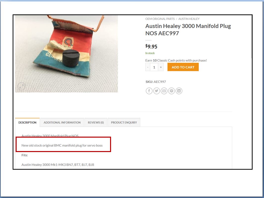

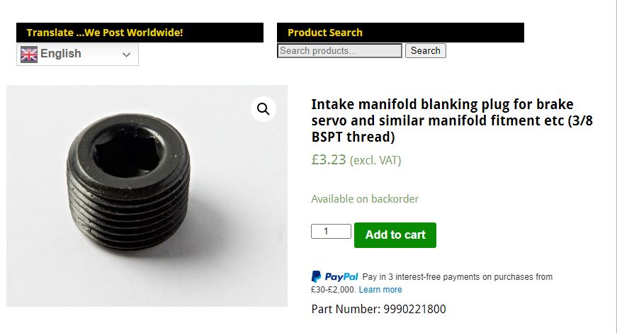

The Servo Port plug is part number AEC997 and I believe it is most likely a 3/8-inch BSPT threading. If wrong, hopefully someone will correct me.
Regards, Bill
