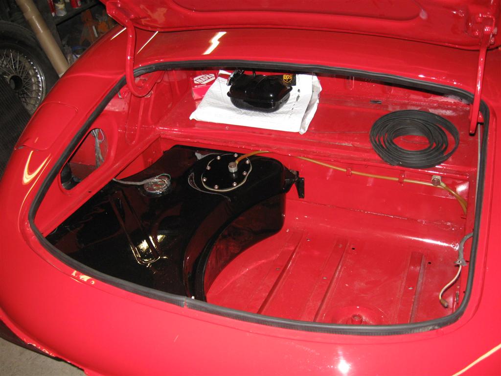

Another EType owner who has user POR15 on his EType gas tank sent me some pictures. Here's his POR15-coated Tank in his beautiful red EType.
JodyFKerr
Dang. Looks pretty! I love how nicley POR-15 looks after painting. I use cheap chip brushes to put it down, and as long as the prep is good, the finish is near flawless.
