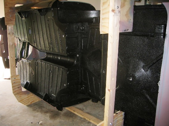

Gliderman8
I completely coated the underside of my TR6 with a bed liner product. It is also used in marine applications. So far it has held up nicely.
Gray_Cat
Elliot:
That looks great - how did you apply it? If you used a spray gun, what size nozzle did you use?
Thanks!
Roy
Gliderman8
Used a roller that was supplied with the coating material.
I think a sprayer would have clogged up quickly because of the abrasive material mixed into the coating.
Gray_Cat
I would have never guessed - it really flowed nicely and looks smooth, excellent job! That encourages me to do the same with my BE whenever I get to that stage.

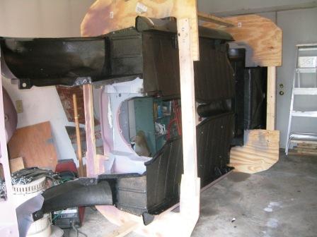

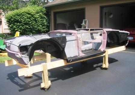

Gliderman8
jackag91 said:
thanks for the feedback.
Elliot, I would love to see some more pictures of your cradle.
Here you go...

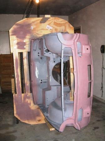

Gliderman8
Here's what I built to move the body around...
