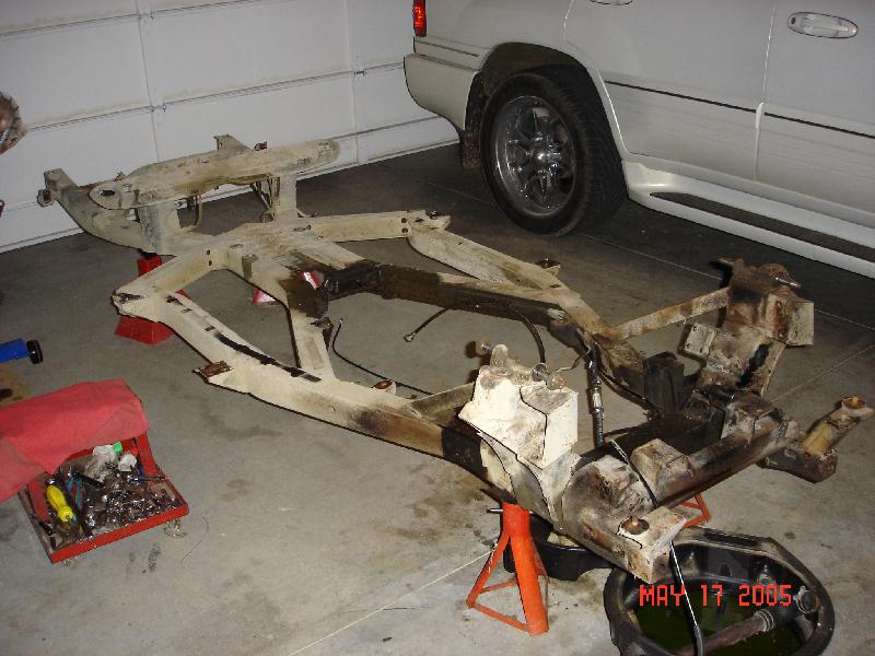

O.K., I've researched all the archives here and other TR forums and I need to make a decision with respect to what finish to use on my Frame. I'm just about done stripping it all down.
Until last week, my mind was made up to Powder Coat it but the Body Shop that is painting my Tub has quit using the process for frames and suspension parts and is exclusively using POR15. While in his shop, he took me over to a frame from a project he is redoing due to an accident that was Powder Coated almost four years ago and rarely driven. He hit it with a hammer (lightly) and the finish cracked and a nice chip flaked off. Next, it was on to an a-arm from the same car that was POR15'd at the same time and wacked it very hard, no noticeable change in the finish. He claimed that for years he had been Powder Coating Frames because it was easy to send out and fairly cheap but swore by the POR15 for the small parts he could bead blast in his small cabinet.
After the example, I have been bringing all my small bits to my office, bead blasting and POR15'ing them, the finished product is pretty spectacular. I have a Powder Coater lined up to take my frame next week but am having serious doubts. Does anyone out there have any long term experience with the Powder Coating and its related durability? Everything I read about the Powder Coating process sure is convincing that this is the right approach but seing the example first hand by my body guy has me questioning my decision.
Any help would be greatly appreciated.
