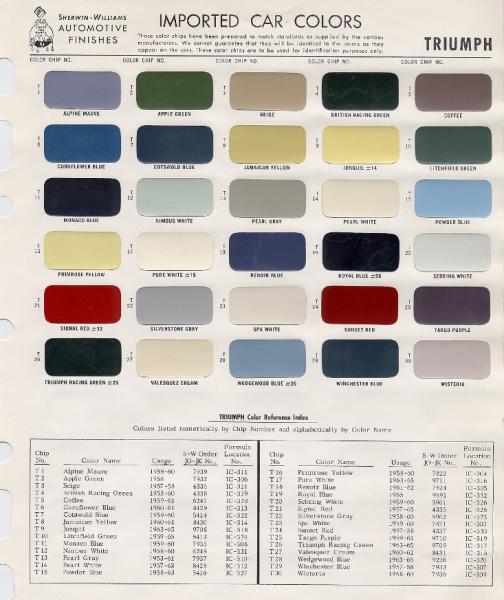

Others have been down this same path (although not AFAIK for Sebring White). My opinion, you are overthinking it. No one knows exactly what it was, there is no Pantone reference, so whatever you wind up with will only be an approximation. It is also very possible that it is impossible to reproduce the exact original appearance using modern paint.
So, my solution would be to pick an off-white that is somewhat close to the preserved color chips, and let it go at that. (To my eye, it looks just a bit grayer than pure white, no tint.) You can even tell everyone it is "Sebring White". After all, since no one actually knows, they can't contradict you.
martin-senour-colors.jpg~original

I've seen a lot of on line paint chips including the 2 above. One other that I did see must have been a later one because it had Leyland white under the Sebring white. They were very close. I originally painted my 3 in 1980 Leyland white because it was the closest I could find then. However this time my goal is to get it as close to the correct color as possible. I'd love to get my hands on one of the original paint chips. Could do a lot with it. Geo that's your call if you want to contact the owner. That would be great and you never know. What I did for my TR250 paint color was to take a copy of the PPG tinting formula and taped it inside the trunk so I would always have the correct formula handy.

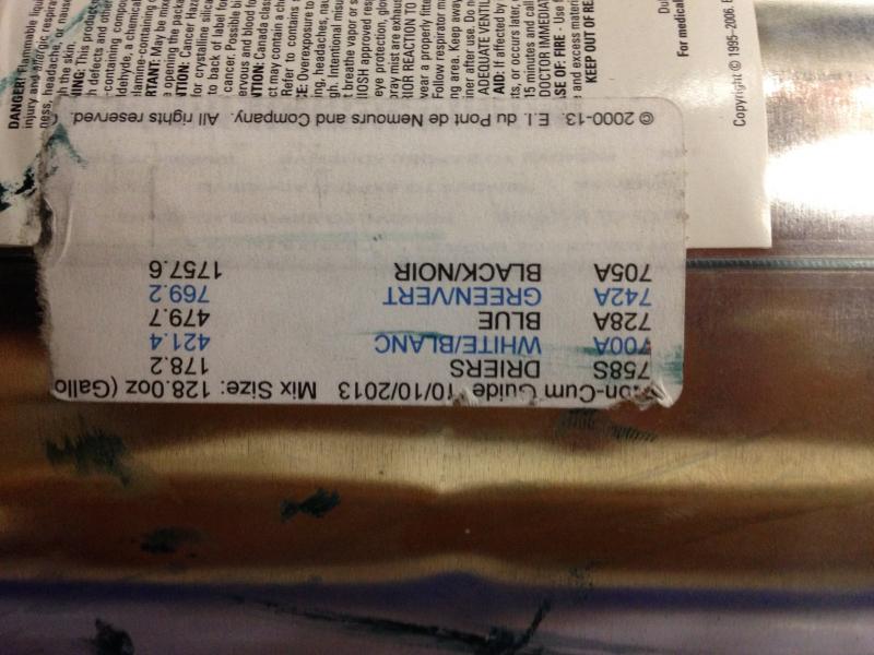

I hope this works for you on the code. The other 250 in the photo is the owner that we bought our 250 from. (who need's two Triumph's)

Is that the formula for the Sebring white 3 in the pic on the first page? My wife Keeps asking me how many Triumphs do you want? My reply is always, just one more! I'm at 4.

What are all those item numbers? Are they the correct color or how do I get the Sebring white formula to order?
glemon
Go here: https://www.autocolorlibrary.com/ find the paint chip sheet for your color, enter the name and code for the color and it will give you pricing, many times you will have to look at a different year (usually later) to find the right paint chip, in this case I think you need to got to 63 or 64 Triumph chips.
Once there you will see the pricing for the various paint options, I was happy with my Triumph Signal Red, and I saved a lot of money.
