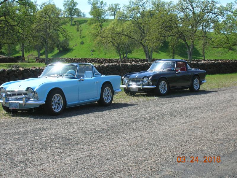

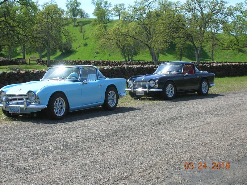

About three years ago I was able to find "a" paint code for the powder blue. I took it in to our local auto paint supplier. He was not able to find such a number in his books. My next option was to take in the trunk lid support ( for the TR4 that I was wanting to paint). I figured that it had virtually no sun exposure or fading and ask him to match that paint. He did and in my opinion it came out great. All said I now have the mixture that he used to prepare the paint. It is not the original number. If you want the formula that I have please just respond.
I will add that I had my car parked near another newly painted powder blue car and that owner claimed it was painted with the original paint code. So it must be available through some dealers. The difference between the cars was fairly great. I would say my car was a lustrous powder blue while his car was such a light blue that I would not have called it powder blue but almost an off white to the blue tint. One other difference between the cars was that my car was painted with one stage acrylic enamel while his was two stage with the clear coat. I do not know how much difference the type of paint made.

Yes I would love to have it and shoot me a picture of your car! I am not going for a concours restoration I am just trying to recreate the way it was when my father in law originally purchased the car.
Charley

Thanks charley nice car, my guy can't get that paint though

I will try to attach a photo of the car as well.View attachment 48567
Charley
