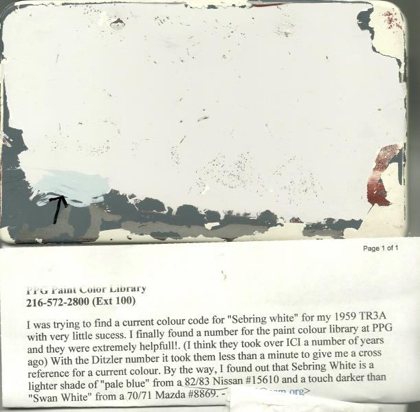

In all my haste to get to paint I forgot to do the spare tire cover and the air intake lid. Last night after striping the air lid I noticed a bit of a different color showing through. I carefully scraped it back after applying a small amount of paint striper to soften the top layer I was able to revel two 3rds of the color under the lid. It is defiantly a very light color and more of a very pale blue or green. Can't say that it is the original color of my car because when it was being stored in 1976 a storm blow the barn down and crushed the cowl. I got a different front clip from start Your Engines and can't say that the new clip was missing the air intake lid and I made a switch. But the color looks almost perfect to some of the chips I see on line and what you guys sent. however nothing like the 3 in the pic that GEO sent. I realize that there are many variables that affect the colors we see on the net so I'm not convinced yet that it is Sebring white. I've been trying to get a good digital pic to list but they haven't been coming out correctly. I'll keep trying.

The attachment is a copy of a email I found on the net from another forum. There is also a pic of the intake lid I spoke of earlier. As you can see there is a color difference between the off white edges and the light blue/white center. Also at the arrow that color is the Nissan color listed in the email. #15610. It's a closer match in person but very curious to see the other Swan White. Half tempted to get both colors and mix them together and see what I get. Also at a Ford dealer looking at the truck colors the 2014 truck/suv flyer the frozen white is a dead ringer to the color on my car's intake lid.
