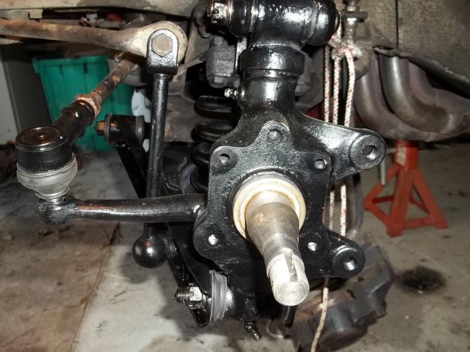

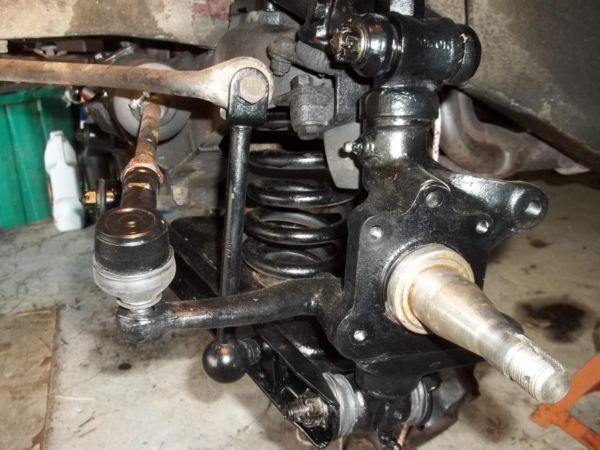

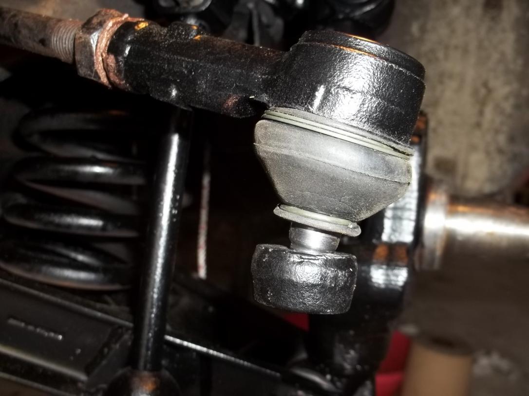

Well, I must be an idiot...I~thought~I had everything in the front suspension back together properly until I just now tried to attach the new tie-rod ends !! Please take a look at the photos and tell me what's wrong. Do I have the sway bar hooked up incorrectly? As you can see, the tie-rod end is crooked to the steering arm. I'm flummoxed. Thanks.

Another DUHHH in my life. I didn't realize that the tie-rod end pivoted. Once I learned that, I moved it until it fit. Learning all the time !!!
Tugboat
Gary,
Not to worry. I had precisely the same "Oh F&#*, now what do I do," moment last weekend and the same resolution as you.
Mike
