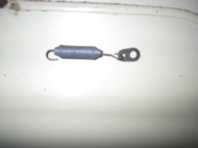

Where do the ends of this return spring go?

Not sure if that's the throttle or choke return spring. Looks like throttle.

The tab is attached to the arm for the throttle and choke shafts, retained with a washer and cotter pin. It's the return spring attaching point. The other end of the springs are attached to the heat shield. Three springs in all, IIRC, all the same.
Photo is the choke actuating arm and cable receiver.
