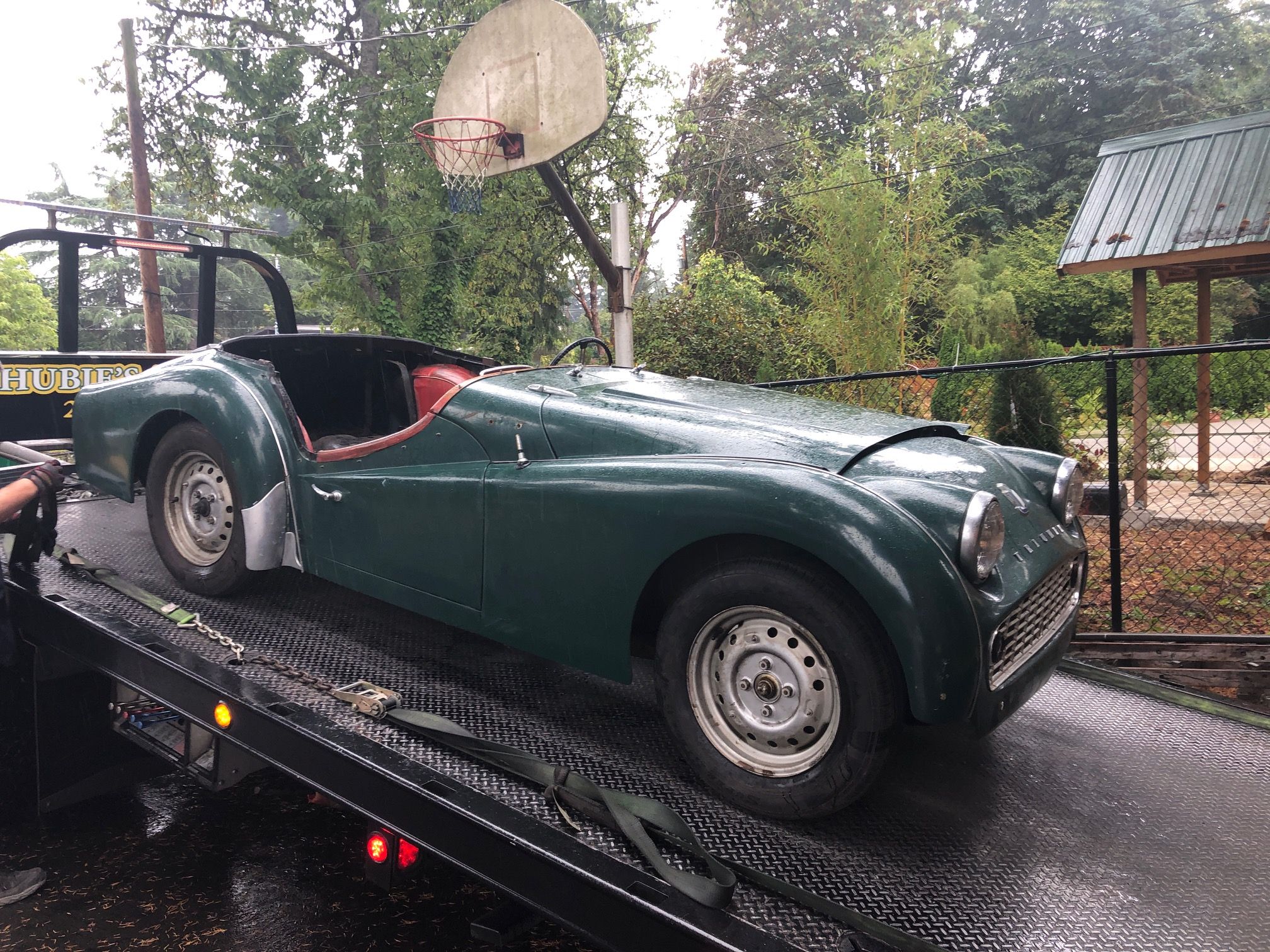

4. There are a lot of deep scratches on this car down to the metal with surface rust. Looking for some direction here. I can sand it down and prime, then the car is going to look like crap. Or leave the surface rust/scratches? It will be a long while before I can afford to repaint this car, all y money is going into getting it drivable. See photo.

4) Deep scratches could be attended to by carefully sanding just the rust then using a paint pen to cover it till a paint job can be done.
