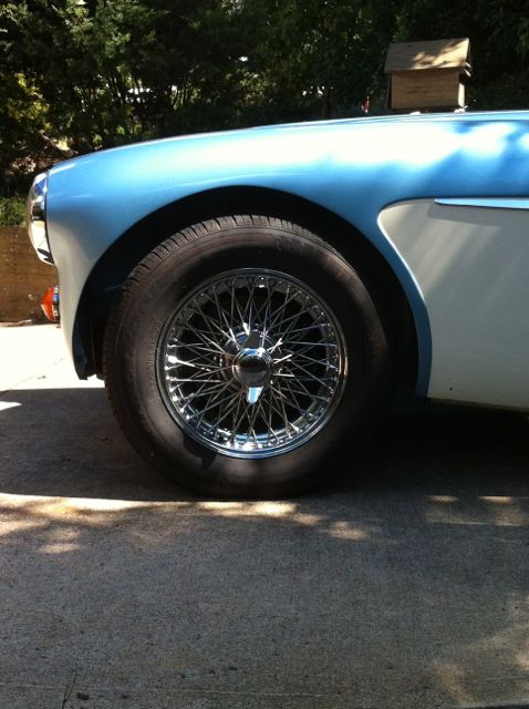

I lowered my BJ8 using the spacer method:
Before:

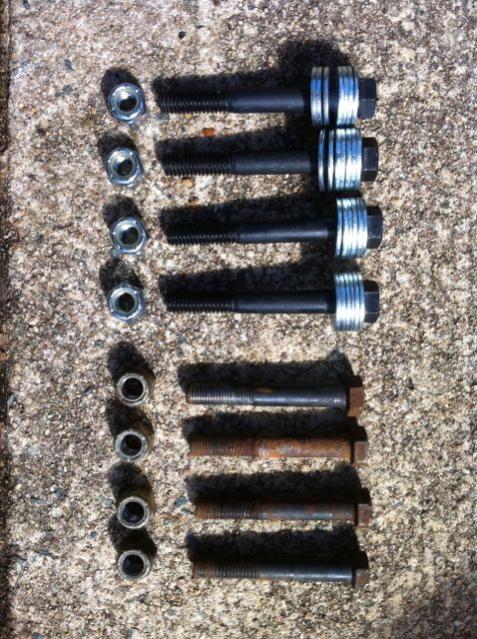

New bolts with washers for spacing:

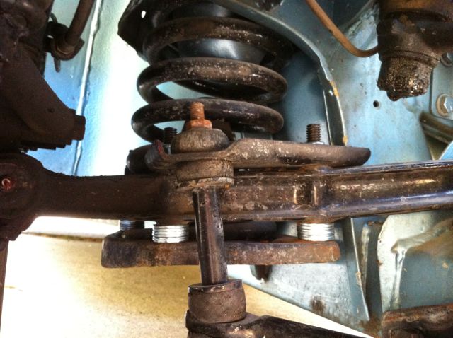

Bolts in place with 6 washers all around:

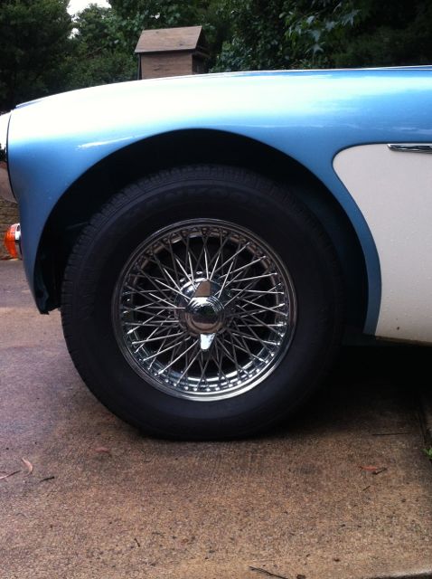

New ride height = happy:
