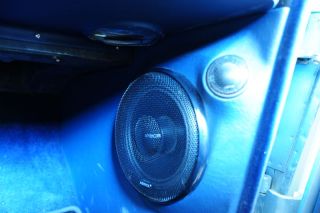

Just got my Healley back from having stero installed. I went back to the post "The Sound of music" looking for advice but only found comments of under dash speakers which just didn't satisfy me! Enter the new dawn of Healey streo systems! My apologies to the purists!

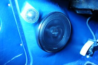

I can say I'm quite happy with the sound even at highway speed with the top down. Granted my header and 2" exhaust still fill the empty notes!

Great job. I know it will provide a great deal of enjoyment …. especially on longer drives. I like how you installed the speakers. Did you need to cut the kick panels to install the speakers?

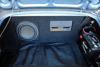

Over the years of owning my Healey, I too wanted to hear something more than the sound of the exhaust. A while back, I decided to install a modern sound system and chose an Acura Bose system with a head unit containing an AM/FM/Tape/Disk, equalizer, and sub-woofer/amplifier in my BJ8 P1.
To retain my original console and BMC radio, I decided to replicate the vertical dash with an appropriate angle and width to allow the head unit to be installed and clear the heater box. Mid rang speakers are installed in panels on each side of the vertical console with sufficient baffling to separate the sound. Directional tweeters have been installed at each end of the dash with the sub-woofer within the spare (wheel and tire as the enclosure not perfect but OK) and amplifier under the battery.

His mods are extremely well thought out and tasteful. I installed speakers in the kick panels as well, which did require cutting into the steel panel and probably not for everyone. The nice thing of installing there is the inner part of the fender makes a good speaker box for some better sound quality.

Great job with your system! Love the idea of the subwooker in the spare! I ended up having a set of new kcks put in with the slimmest speaker I could get which was Hertz. I'm not sure how the car installers do it but they custom make the kicks and I ended up buying some extra material from Heritage Upholstery to match originals kicks that I now have in storage. Don't really lose much foot room given I was blessed with size 12's!

Kenwood KDCX994 Head unit with USB plug and detachable cover plate. USB great for MP3 player or iphone
Kenwood KAC8405 Amp
Kenwood KFCW100F Excelon flat 10" Woofer
Hertz Space 6.5" Component Set
