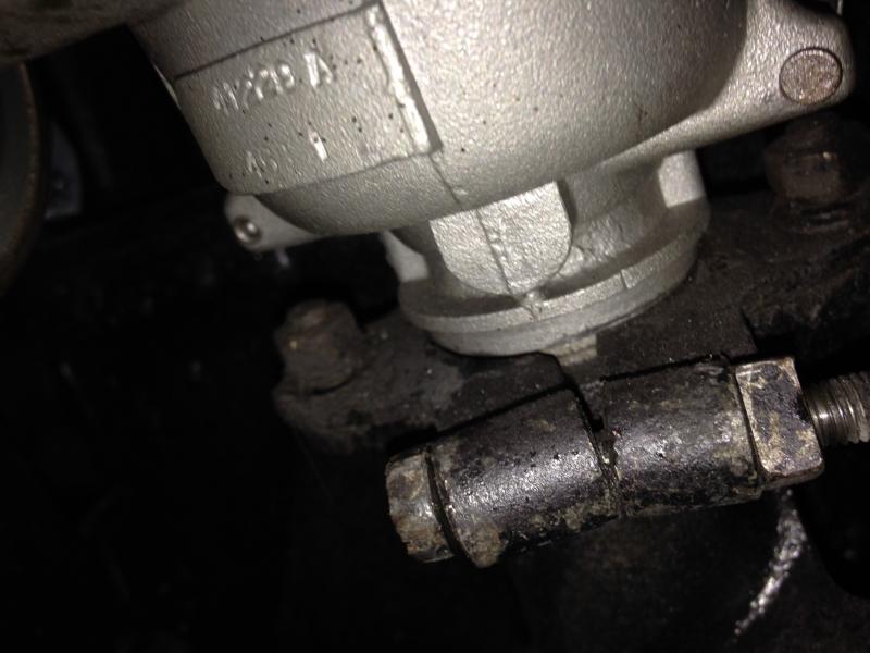

However, I realized the fixing clamp is not raised enough to secure the base of the distributor.

any reason not shim the fixing clamp collar a half inch, so it can snug the base of the distributor?

I think if you open the clamp up, you'll find that the distributor body will slide down where it belongs. If not, I'd look for the reason why as it may indicate something else wrong.
Don't get carried away when retightening the clamp. The body is just pot metal and not very strong. I've seen people crush that flange where the clamp is supposed to grip.

Maybe I did over tighten: I was cranking away before I realized I wasn't getting anywhere.
The flange looks OK in your photo, so I think you're probably OK on that score. But you'll probably need to take the bolt out and pry between the ears to get it to open back up far enough. Maybe loosen one of the nuts as well.

FWIW - That appears to be a distributor for a 1971 Sprite or Midget.
Don't know about that, ( how can you tell?) but it works pretty well, when it's tightened down properly.
( Randall was right, I had the collar cinched down so tight the base of the distributor was Teed up like a golf ball......it made for some impressive backfires for some reason). No telling what damage I did!

So you're reading that last digit as a '9' ? Looks more like an '8' to me.
And while the housing is obviously wrong for a 3A (though it would work more or less); that doesn't mean that someone hasn't swapped around the internal parts to be more appropriate. The surface looks bead blasted to me, which suggests some rebuilder may have been at it. Internally, only the springs & point cam are different between different versions of 25D4 (plus the vacuum module of course).

So you're reading that last digit as a '9' ? Looks more like an '8' to me...
It is hard to read, but 41228A would have originally been a 25D6 (6 cylinder engine) though, as you note, any 25D distributor body could be reworked to almost any other configuration if internals are changed.

I dbl checked that model # is 9.

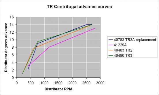

No way to answer that question, until we know if it has been modified. But even if it hasn't, I don't think you'd notice a big difference. The Sprite advance curve is less aggressive than the TR, but you can compensate for that by bumping up the initial timing (if you don't use the hand crank). Here's a quickie plot of the centrifugal advance curves.

And on a distributor that old the curve may differ from the original anyway as springs may have been changed or at the very least gotten weaker.
A friend has a Sun machine and last week I was able to see the advance curve I am really getting on one of my distributors. It was at variance from the factory spec though the engine runs quite well -- no change will be made but good to know what I have:
A key number you can find out (and possibly tune for) is what advance you see 'all in', i.e. the advance at high RPMs. Set that about right and the rest may fall into place.

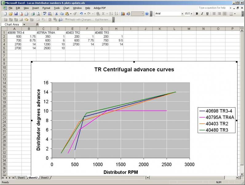

Randall - What application did you use to produce that graph? I suppose I have something that would do graphs if I took the time to dig into it. Thanks!
TR3driver
Great Pumpkin - R.I.P
It's just an Excel spreadsheet. Probably not the friendliest/easiest software to use (and certainly not the cheapest) but I kind of got used to it at work. If I were starting over, I'd probably go with something like Open Office's Calc
https://www.openoffice.org/product/calc.html
Geo Hahn
Thanks, that pretty easy to swipe (I've got the intro version of Excel (aka 'Bill wants you to buy the real one') and will set it up.
