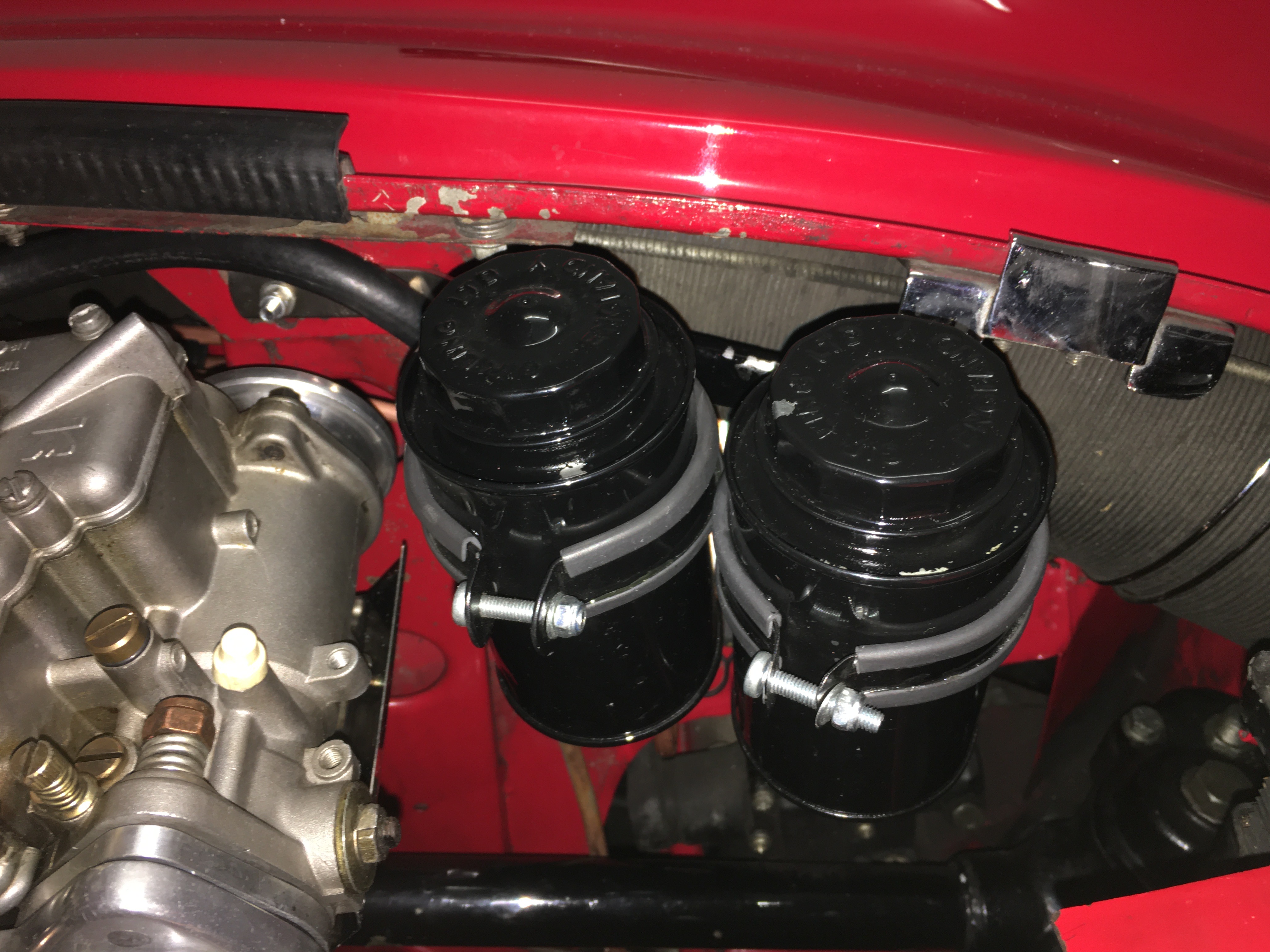

Does anyone have a tip on where to get decent Girling brake fluid reservoirs for my BN7?
The ones I've ordered online keep leaking and destroying my paint. (Tried the "no leak" seals already).
It seems that most online vendors sell the same poor quality rebuilds.
Due to an upgraded two-circuit brake system I would require:
  • 1x reservoir-can with dual outlet for both brake and clutch
  • 1x reservoir with single outlet for the second brake circuit
Any feedback on where to get matching high quality reservoirs that look original and definitely don't leak is highly appreciated! :smile:

Hi Steve, thanks for your reply. My reservoirs are actually not leaking at the bottom / connectors but rather splashing on the top end at the lids. Either the fluid comes through the breather-hole or through the thread of the lid. I've tried other seals already. Reached out to pegasus as recommended.
Have you tried the "no splash" seal that Moss sells? Part #582-505

I have one in my BN2's reservoir--it works. But, how high are you filling your reservoir? Brake fluid gets hot, and hot fluids expand; I fill my reservoirs to just below the top of the cylindrical part of the reservoir or, for the BJ8 I fill to the top of the clutch cylinder (easier to tell if anything is leaking). Like radiators without recovery systems the system will find its own level.

Fat Cat, I’ve had a similar problem but not very severe. I have what I believe is a very good reservoir bought from Healey Surgeons in Maryland, but the cap is so tight on the threads that it doesn’t thread down far enough to compress the gasket enough and the fluid can squeeze past it. It is not much, but it is enough to see some around the top edge. Also, on very long drives, I have been able to get my fingers wet if I put them at the bottom of the can, but I know it is not the tubing fittings at the bottom because the flare nuts and tubing are never wet. The can sides will show some wetness so I know it is coming out the top. I use silicone fluid so it doesn’t even damage the paint on the can, and the weeping is so minor that the level of fluid in the can does not seem to go down. Yet the can is wet. In my case I blame the cap.
I was going to change to more modern plastic reservoirs. I bought a dual reservoir plastic set up from Summit Racing. It uses rubber hose to connect to the copper tubing. It would fit well, but because my problem is minor I never installed it. It would be clean and leak free.
You could lower the level of fluid in your reservoir to see if that helps. Remember the standing fluid above the master cylinders is the whole tubing and the can, so you really don’t need much in the can.
