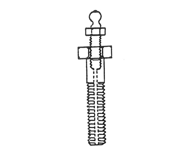

Restrain the piston that moves, and get more pressure. One solution, given by Bob Schaller in "More BS", is to adapt a grease gun to the inlet fitting. A full size grease gun can develop 1000 psi or more.
Another is to hook it up to the system (blanking off the other ports in some fashion) and stomp on the brake pedal.
Yet another is to fill the interior of the caliper as much as you can with solvent (eg Gumout) and block off the port with a bolt and nut (maybe a copper washer if you've got one handy), then start heating the caliper with a propane torch. The heat will melt the seals and boil the solvent, forcing the piston out. Best to wear face protection though, as the escaping vapor may catch fire, producing a brief ball of flame.
Don't get in the way of that piston if it comes out under extreme pressure. It will probably scare the crap out of you as well.
Oh, yeah, forgot to mention, it's best to have a piece of wood for the piston to hit, especially when using that last method.
