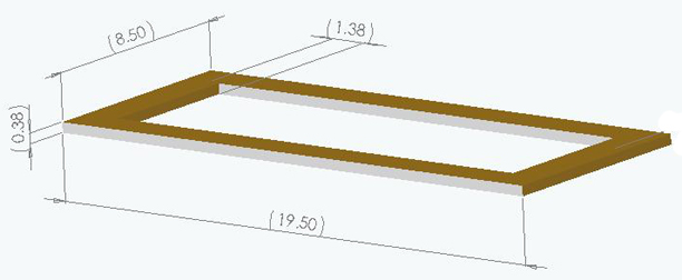

Hi John,
Don't know if you need this, but I have dimensions of that gasket.
J
John_Progess
Greg,
Thanks that helps alot. I have some 1/2" thick close celled foam I am planning to use. With this information I can cut it out in one piece. I assume that all four sides are 1.38" wide. On three sides the gasket will rest on the frame but on the forth side the lip on the trunk back wall is only a little over 1/2" wide. Is this normal? Thanks again and have a good day!
John
GregW
Platinum
Hi John,
Yeah, all 4 sides are 1 3/8", not really sure why my program rounded .375 to .38, but there ya go. As far as the ½" lip at the front, I have that too. Seems like the foam would be overkill, but more surface area will help the glue hold the foam in place.
