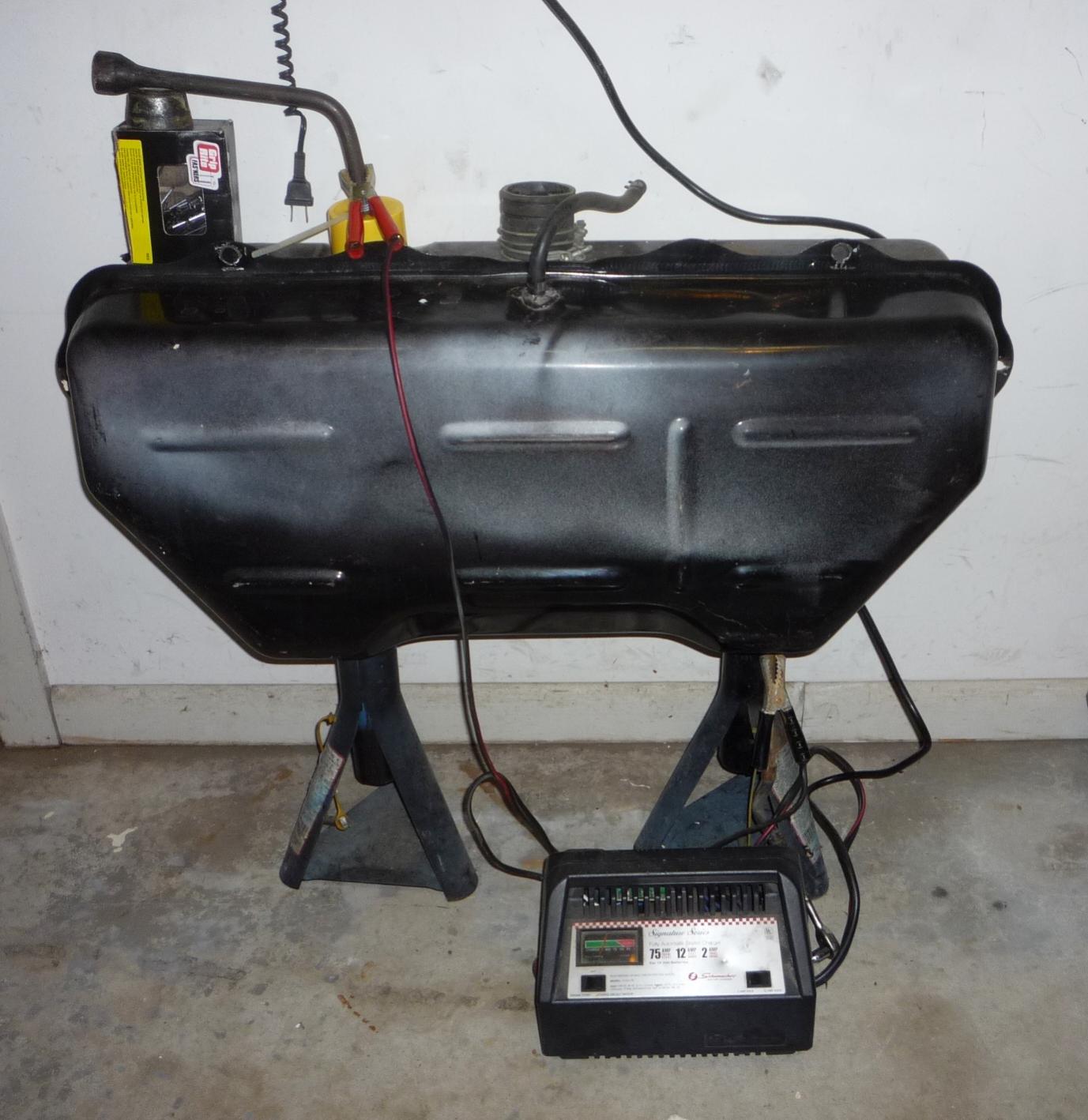

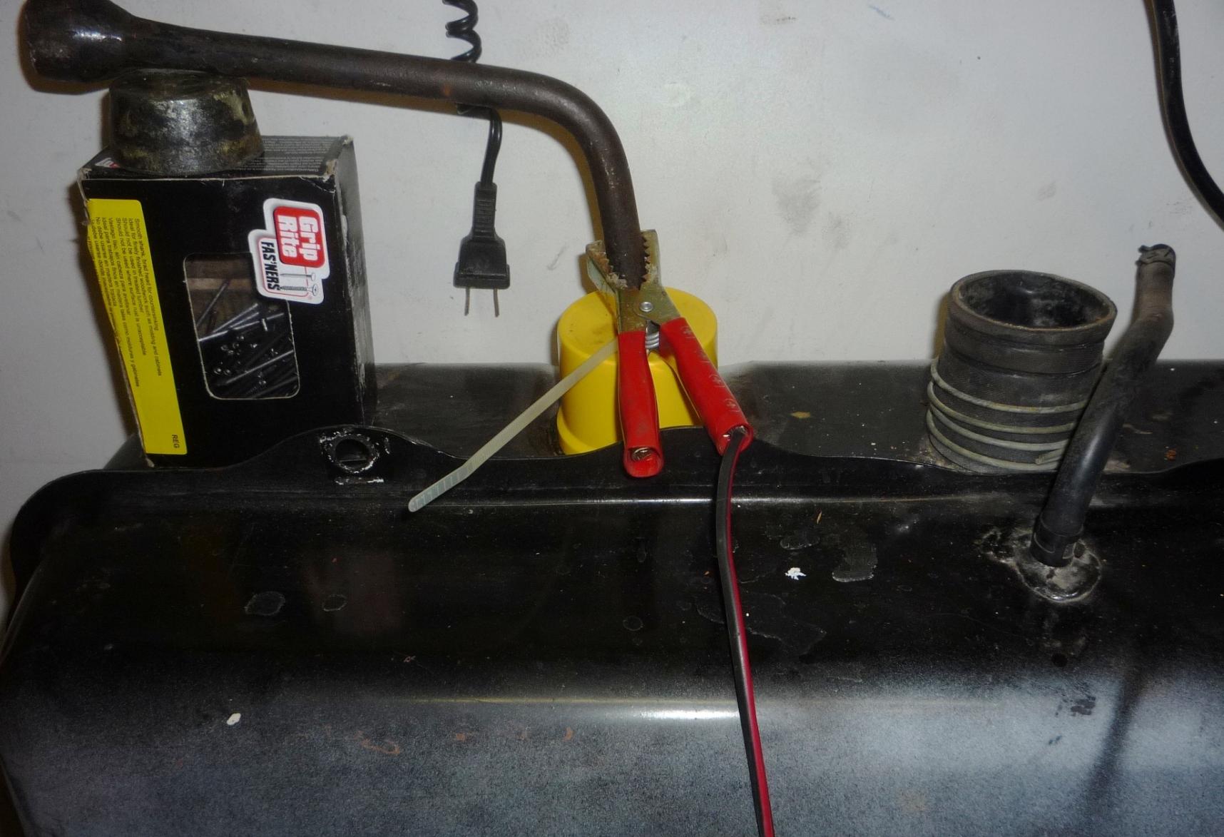

Since there was some rust (initially I didn't think there was any rust) I decided to try cleaning it via electrolysis. I filled the tank with a mixture of distilled water and Arm & Hammer Washing Soda. Then I took an old tire iron and used it as a sacrificial annode by taking a plastic spray can top and put the tire iron through it. The cap keeps the tire iron centered in the opening where the fuel gauge goes. It's important that the anode does not make contact with any part of the tank.
I hooked up my battery charger..... negative to the tank, and positive to the anode.
Every few hours I remove the anode and clean all the rust that the anode attracts. It appears to be working well, but will know more in a day or so; I intend to let it "cook" for another day.
It's environmentally friendly and the only cost was the Washing Soda (it makes a good electrolyte to conduct the current).

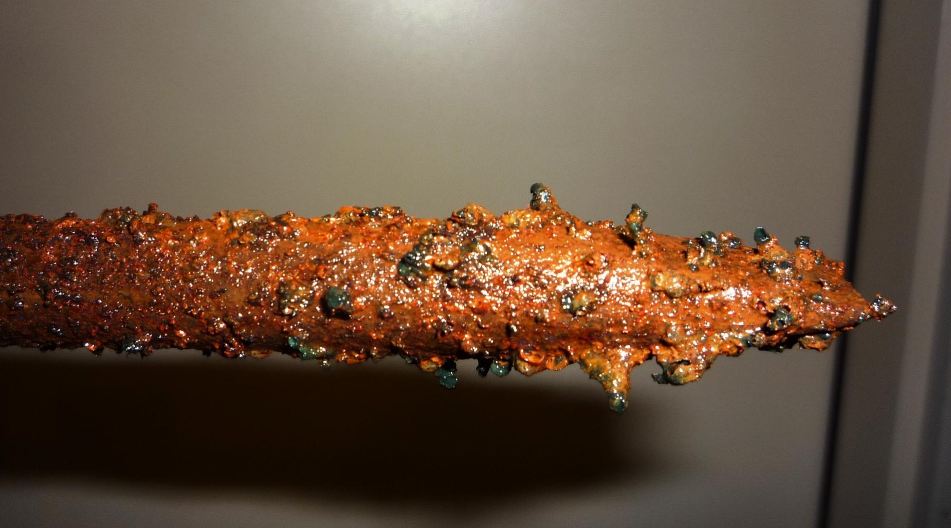

Here's a pic of the anode after only 2 hrs. in the electrolyte solution. It was smooth and clean before inserting. As you can see, the rust is being removed from the tank and adhering to the anode.
