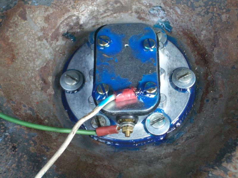

When you say the replacement parts have never worked correctly, does the tank/sender have a good ground connection? You can make one by crimping a ring terminal to a length of wire. Secure the ring terminal to the sender using a sending unit mounting screw. Attach the other end to the car's chassis.

The threads are in the tank - sender just has holes. I've been running 10-32 panheads with bonded sealing washers for 12 years:

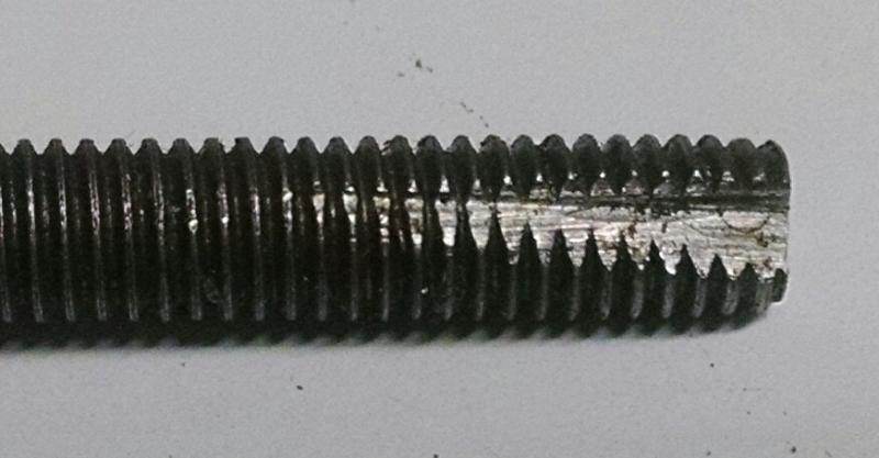

If the M5 is going to work, you could make an impromptu tap out of an M5 screw:

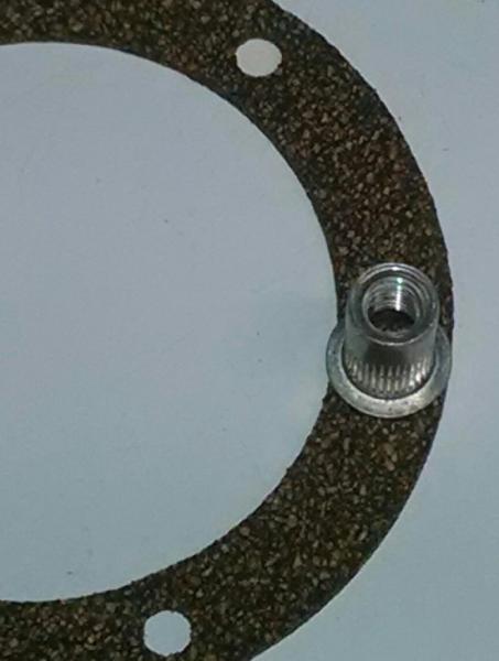

I would over drill the hole and fit a countersunk rivnut sealed into place with Petseal. A new cork gasket too.

Rivnut inserts are indeed a possibility. However, if you install one you might as well do them all. The downside is that the rivnuts have heads which will make it more difficult to achieve a good seal with a stock sending unit gasket. You may get better results making your own gasket from thicker material if you take this route.
