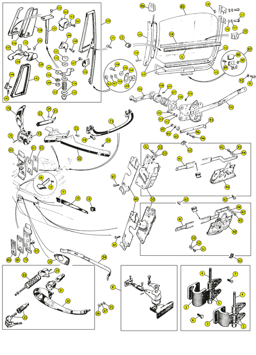

5) The channel at the front of the sidewindows travels up and down with the glass- can that be right?
The glass has a thin metal frame pressed against the front, bottom and a little around the back edge. That frame has some nylon clips attached, that fit into the window frame guides. Yes, the frame/clips that are around the glass, does travel up and down with the glass.
See the Moss exploded view below.
(I noticed you're missing the rubber end cap on the top of the window channel)
