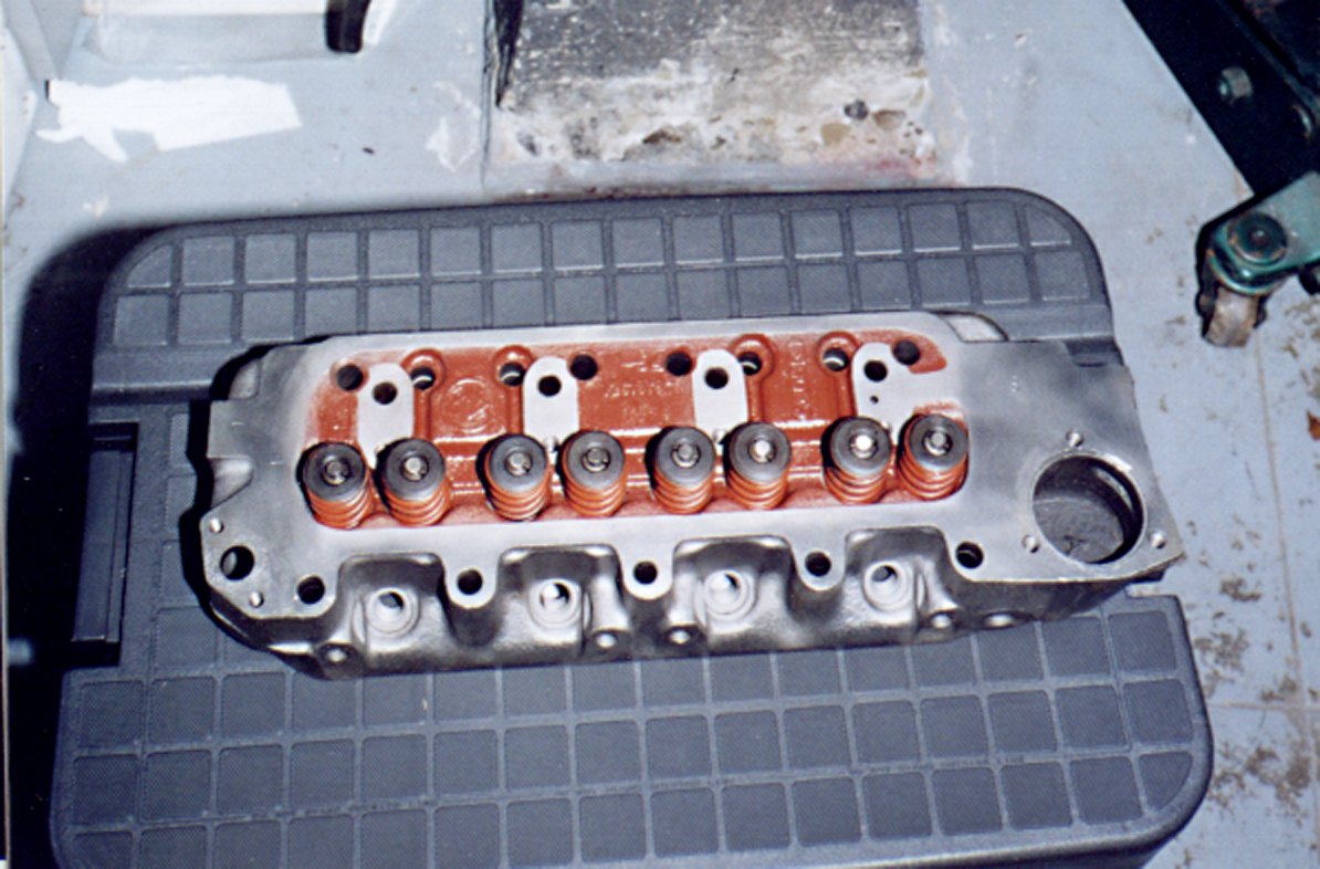

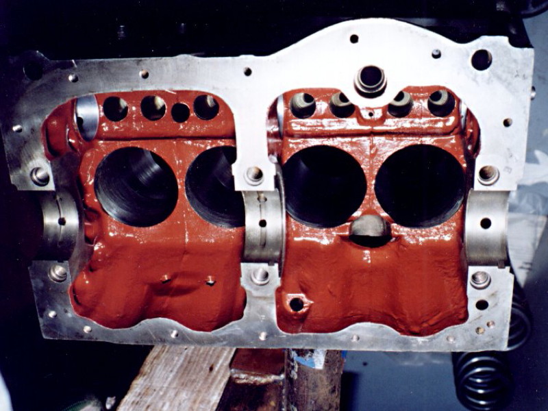

Gerard,
Certainly looks cool, and accepting the "I-know-its-there," and "all-contaminents-removed" and best of all, the "better-oil-return-flow," what about the painting sequence? You mentioned hand cleaning and hand painting. Your pictures looks like you you painted before bore. What about cam follower bores, cam bearing bores, distributor drive bore, oil pump bore, thrust washer face, threads, etc.? What about crank/rod paint? I can imagine just plain good detail hand painting, or honing, tapping. What about paint viscosity, thickness when dry? If it doesn't matter, great. If it does matter, would like to know. Looks like valve springs were painted. Does spring flex matter? Thanks for your expertise. Blueghost.
Gerard
Gerard,
Everything was painted after machining. I don't recall exact sequence, but the hard to reach places are better done first so you don't end up messing up finished areas. Also, areas that require carefully painting around machined areas and borders. Smooth, machined areas are not painted, even if it's not a working surface. Then, just fill in the rest. One trick is to use wine corks in the cam follower bores, but I just painted carefully around edges. (I use artist brushes) The paint is quite thick, so it doesn't run or drip easily. I didn't paint rods or anything else other than what you see, except for the pan. I believe I only did one coat, but some recommend two. I didn't feel two was necessary. I've read also baking is a good idea, but not sure if that's a manufacturer's recommendation or not. It will tack fairly quickly, but it does flow nicely. The springs are not painted, just new and they just came in similar color. The point is just to cover pours areas where oil flows/gravity drains.
