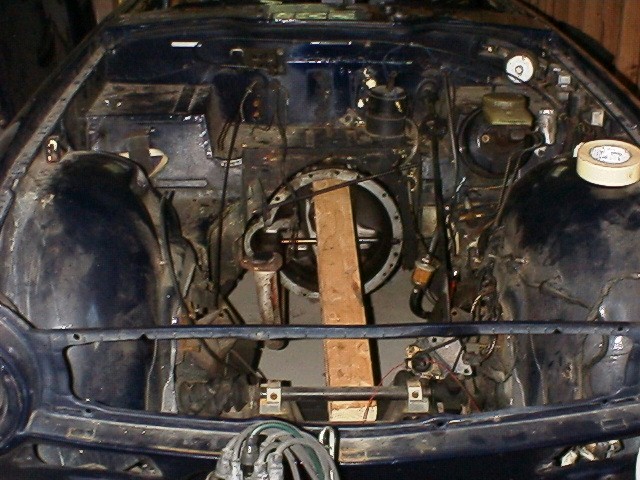

Couldn't resist a before and after motor compartment shot for my TR-6.
Mark

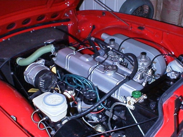

Here is the after....
Mark

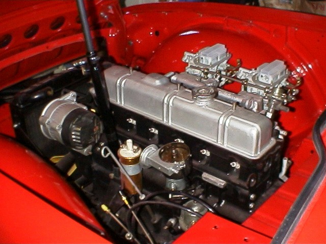

Thanks Shannon, it's much easier to paint the motor compartment when the body is off the frame! Here is the finished engine compartment...
Mark

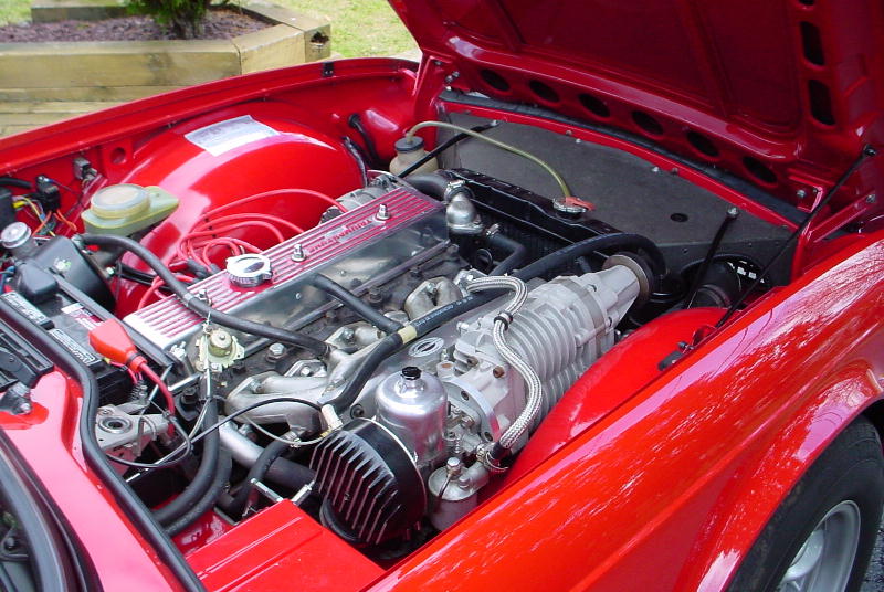

trboost
Both Phantomracer & mark have had great results, the engine bays look pristine. Many years ago there was an article in one of the British car mag's describing a home mechanics guide to painting his engine bay. I wish I could give the author credit but I can't find the article. Anyway to make a long story longer , this inspired me to transform my flatblack sprayed engine bay to the red color of the car. From tips in the article like using tin foil to protect parts not being sprayed & how to pull the wiring harness into the driver footwell, to primer tips from a bodyshop friend, you can achive remarkable results. Enough so that by using spray etching primer, base primer, three coats of Plastickote spray & two clear coats I took a first in class at a local LBC event. Like the author & the pro stated , "it's all in the preperation". The toughest part as you might guess is the sanding & old paint removal. Needless to say, my total cost with paint and materials was well under what a proffesional would have charged, about $100.00.
On most LBC's simply removing the carbs & manifold will give you plenty of room to work making the job much easier. This is a very satisfying project that really makes your eyes pop every time your hood is open. The only real problem is this generaly brings on Shipwrights disease & all heck breaks loose in the engine bay /ubbthreads/images/graemlins/cool.gif

vettedog72
Who will notice the paint! It took me a long time to get my eyes off that enormous super charger.
It really looks like ashow car. I wish you would detail your unders hood paint rehab so I could dream about my next project.
Great job.

trboost
Thanks Vett,
I'll dig for the article & see if I can post it somewhere or just list the highlights.
By the way, the blower came free with the purchase of 20 cans of Plastickote /ubbthreads/images/graemlins/grin.gif
