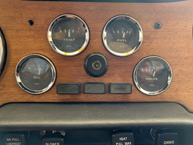

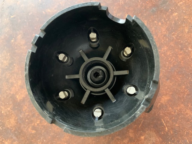

On a drive the other day at 55 mph for about 20 minutes with volt meter reading 14-14.5, engine shuts down. Pulled off to shoulder, tried restart; nothing. Checked the distributor cap to find that the brush has completely disintegrated with what appears to be burnt areas where it was housed. Got car towed home, installed new cap and rotor; started up on first try. Questions??? Was the cap defective? Is there an electrical issue that needs to be addressed? Your comments will be greatly appreciated.

Aloha Willy - Howzit? How does the contact surface of the rotor look? I had something similar happen and checked the cap after it started missing. The brush had broken and was not making contact with the rotor. I found & cut a suitable length of solid copper wire (more like a pin) and was able to drive around for a few weeks. I got some ebay NOS Lucas brushes and replaced the copper wire later. Your carbon brush must have cracked or failed somehow and the spring in the cap that keeps it in contact with the rotor must have been passing the high voltage...until it became too short. Once the contact surface gets rough it would wear the carbon brush pretty quick.

I have not seen that fail and that is a part I have not carried but is food for though. I do carry and extra rotor and polish the top at times. I am of the school that if you carry and extra part that part will not fail.

Aloha Jeff! Thanks for your comments and thankful it's not another electrical problem. The housing area appeared too burnt to receive a new brush and spring. The spring also appears to be melted in there. The contact surface was black with soot but no pitting. I cleaned up the rotor and will keep it as a spare. For now, it is running well with the new cap and rotor.

Years ago I had a similar issue (car suddenly stalling) with a 76 TR6. Long story short, the insulation on the points wiring had frayed and was shorting to ground. Electrical tape solved the issue until I could replace.
