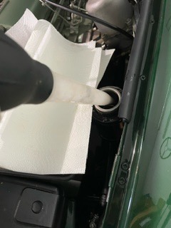

I just suctioned out all the brake fluid from the reservoir with a turkey baster. There was a bit left in the bottom and I got that to with a bulb and hose type syphon. I looked on line and found some brake line and fitting caps advertised. I'm going over to the local parts store to take a look.

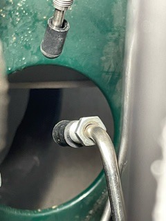

Well, the master is out. I managed to siphon off everything from the reservoir and was able to pump a couple of ounces out of the right front brake bleeder. There was a bit inside the master, but I slid it out without dumping any. I capped the lines with rubber vacuum line caps that are working well.

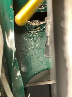

The master had oozed a bit over the years. I found the areas below the flange were peeling both in the footwell and under the hood. I tried to post pictures but I’m having trouble doing it from my phone.

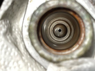

Below are pictures of brake fluid extraction, the caps I used to block off the brake lines after they were removed, a bit of bubbled paint that was found underneath the master cylinder flange when I removed it, and the face of the master cylinder with the boot removed. There was also an area of paint bubbling inside the footwell below the hole where the M/C is mounted. Looks like it had a bit of a leak!

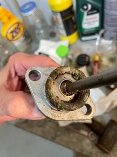

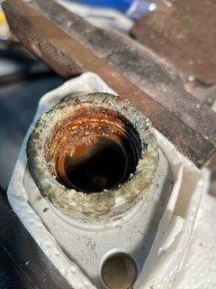

Here are some pictures of the M/C piston, seals and the cylinder bore. I'm thinking the piston got stuck in the cylinder while we were bleeding it last night. In retrospect, I'm glad it did. I didn't know it needed servicing and I would have driven it like this if it didn't get stuck. Time to order a new one.

That looks like iron rust in that cylinder; I received, at least once, what appeared to be an iron cylinder as a replacement (OEM was aluminum). If so, you could probably clean it up, hone it and put a kit in it (but it may not be worth the trouble).

I was very puzzled by that, but then I had a recollection. I need to check my old receipts, but I believe I sent both masters to Apple Hydraulics and had them sleeved. I forget what they use. I seem to recall it was a brass sleeve, but perhaps it was steel.
