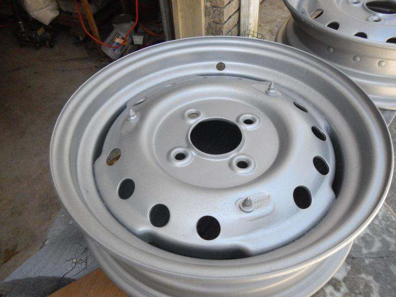

DavidApp
Sandblasted the wheels.
Then I used epoxy primer followed by rattle can Ford Argent silver. That was over 2 years ago and so far they are looking good.
David

DavidApp
Was thinking of powder coating till I got the price. $125.00 per wheel even though I had them prepared. They said that was the price whatever the condition of the wheels.
David
