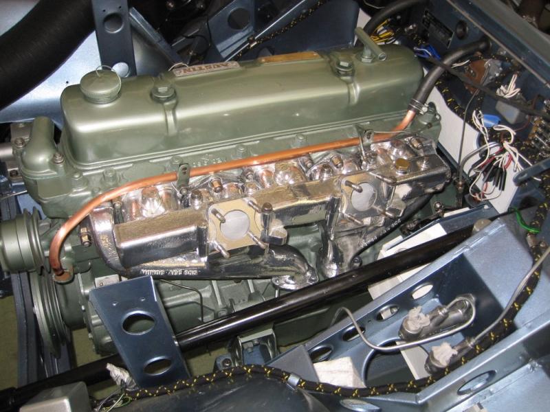

Thank you guys, Randy; great pictures of the engine.
Your engine looks great Randy...........exhaust manifolds look outstanding: what did you use??
Thanks for showing the pictures,
John
Thank you, but that engine is in the Longbridge BN4 that Jim (healeyblue) restored, my responsibility was strictly the engine & xmsn. Jim sent the manifolds to me after they had been processed, but I do not now remember if they had been porcelain or ceramic coated. I was careful, and deliberate, to extend a little overspray onto their flanges (as well as the carburettors) just as the guy at the factory would've done.

The exhaust is a grey ceramic coating my powder coater did. The engine still looks like that today, even after many miles of use.
Rob Glasgow
Here's another option for the manifolds. I just couldn't help myself. When I saw the new Stainless Steel exhaust system, I just had to have the manifolds ceramic coated in the chrome color to match. So much for originality!!! I laugh at myself somethings--I would never put chrome wire wheels on my car, just to much bling. But a shiny exhaust system, well that's another matter....
