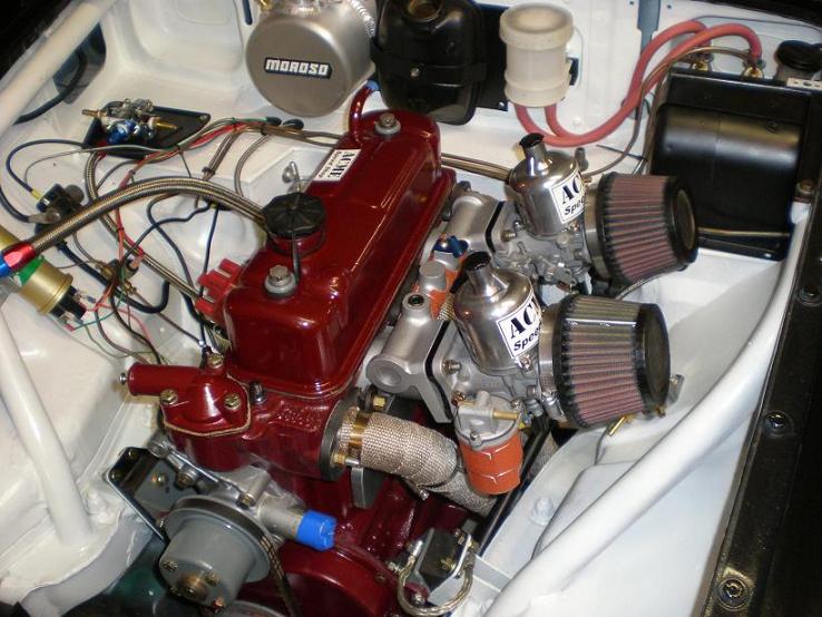

It's on the shelf here at the local Advance Auto Parts, in the Dupli Color Perfect Match line. FWIW, even though engine paint is labled at high heat, you can paint a engine with paint like Perfect match or regular, think of this way you block and cylinder head only get maybe 200 degrees, your hood on your black car in hot sun easily surpass that. I use the DCR on my maroon MG engines all the time, it can bleach if coolant gets on it as well, so can almost any paint, but unlike the Moss engine paint, which is very good paint, that $20 a can and require hazardous shipping, I only get colors form Moss that absolutely cannot get elsewhere, mostly Midget/Sprite Olvie green and big healey met. green, everyting else I can get local for alot less, and no difference in quality.
Here's a DCR MGB race engine I built.

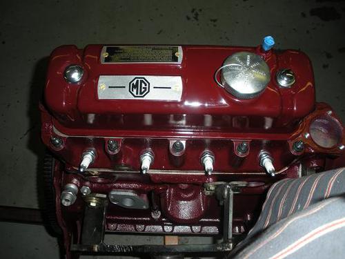

Here's another shot of the top of a MGA engine I built, and used the DCR.
