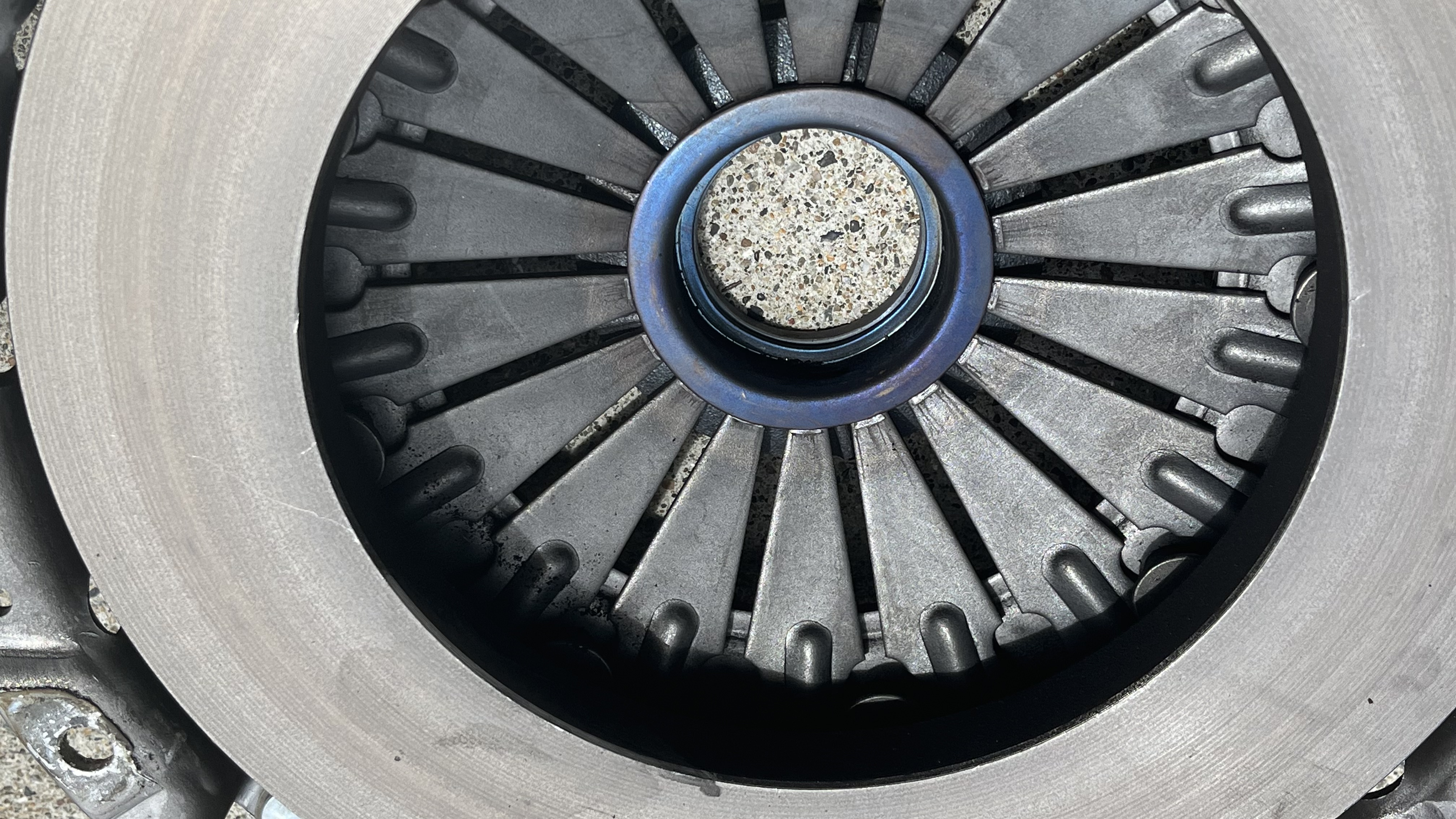

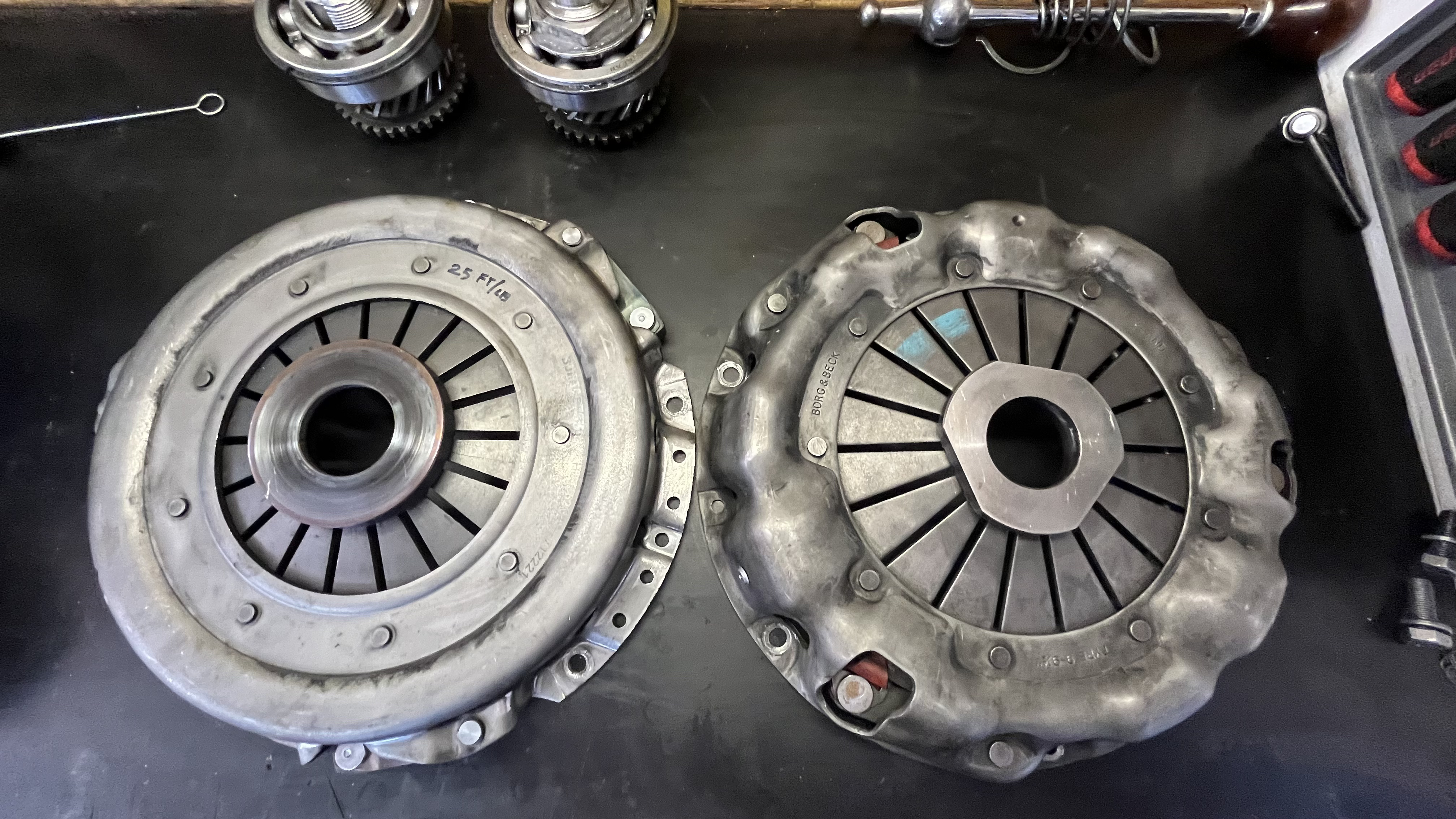

The new clutch release plate is heating up and turning blue. (photo attached, less then 100 miles) The throw out bearing is wearing too much.

I am not riding the clutch. Please look at the plate, it doesn't show any wear. The release plate is blue.

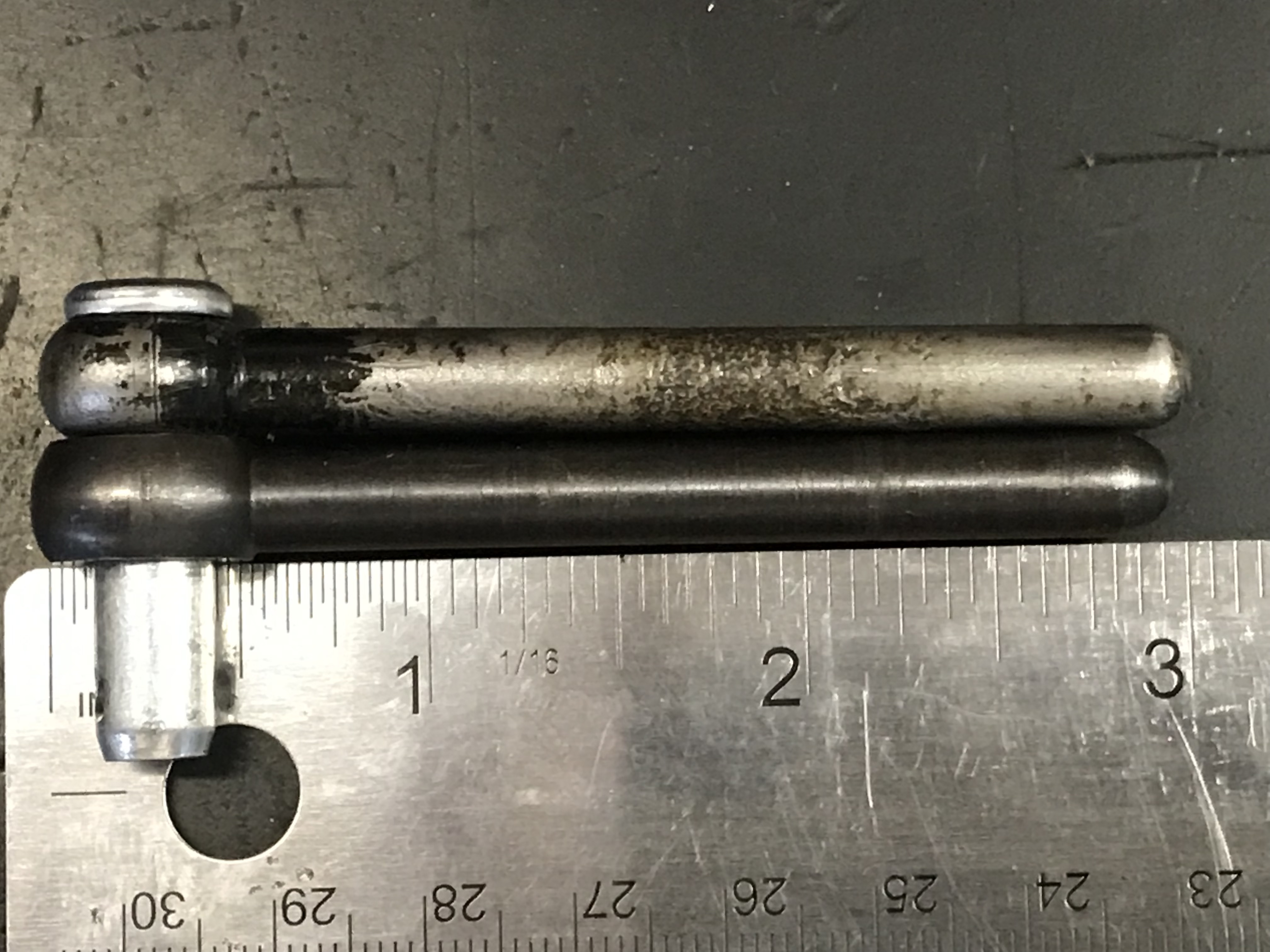

I bought a slave rebuild kit and a new pushrod. Original push rod and new replacement
are the same length.
Being I have two now, should I shorten one and try it? How much should I shorten it?

Original pushrod 3"
New aftermarket pushrod 2 15/16"
(both turned pressure plate blue)

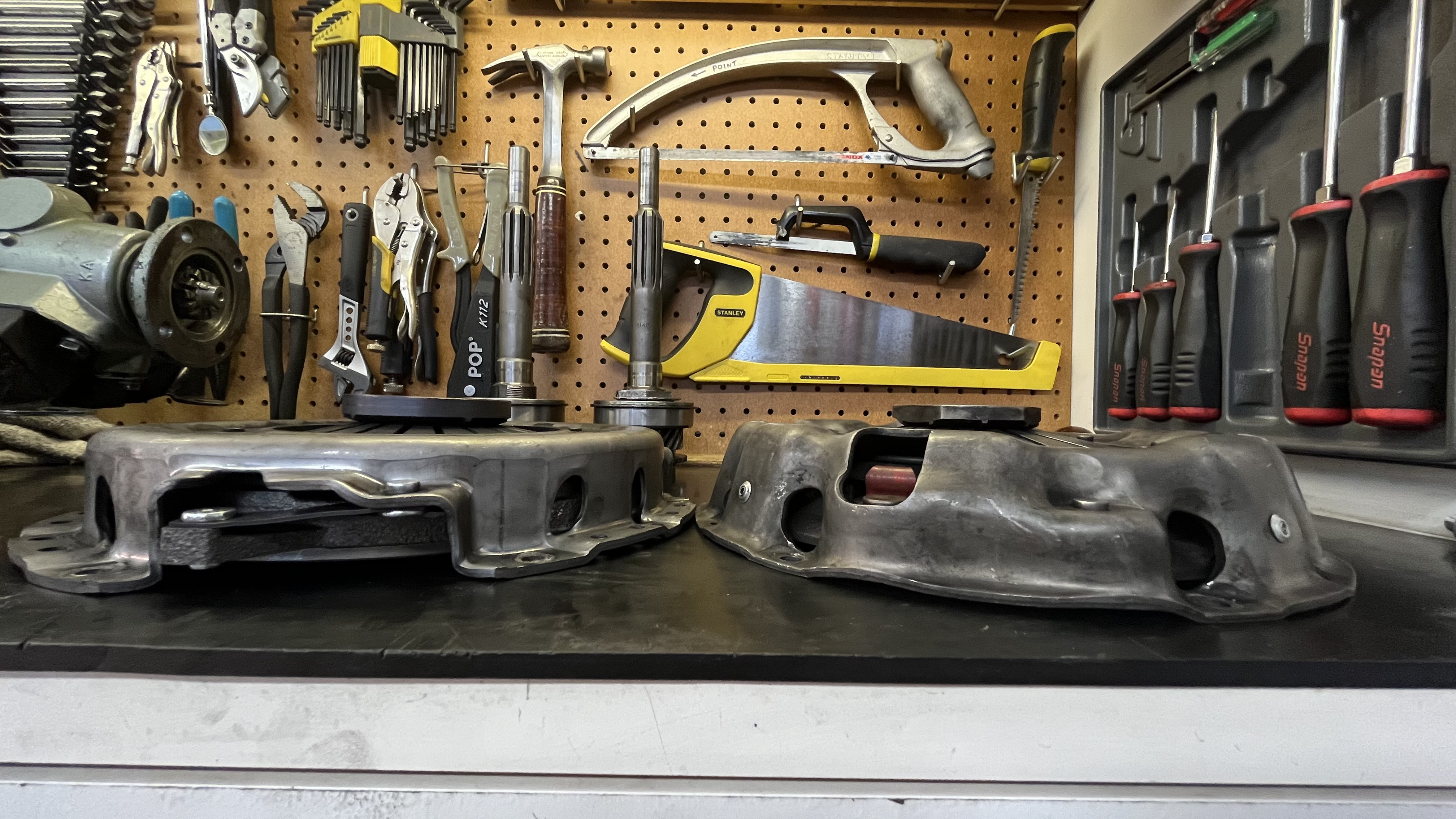

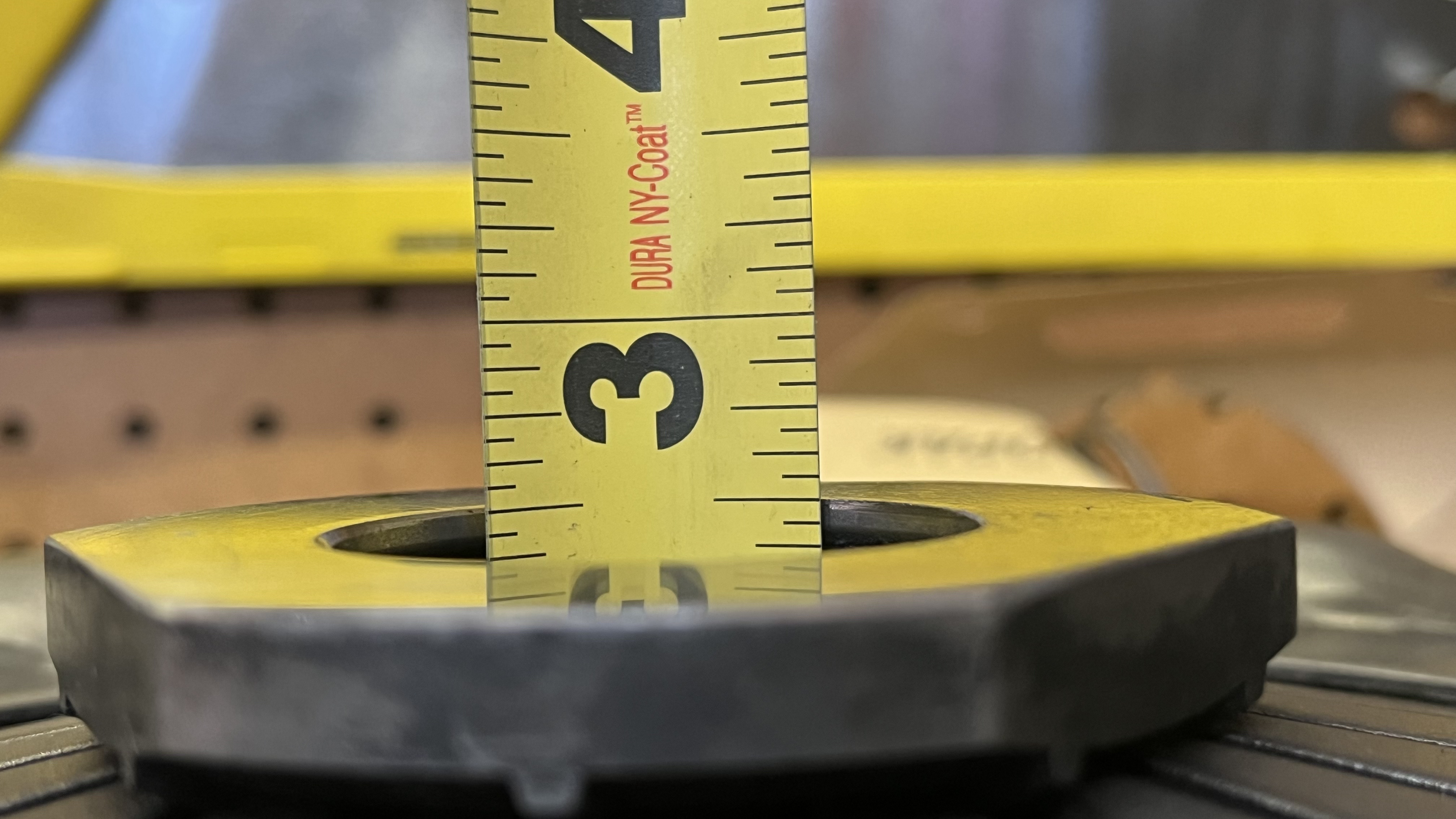

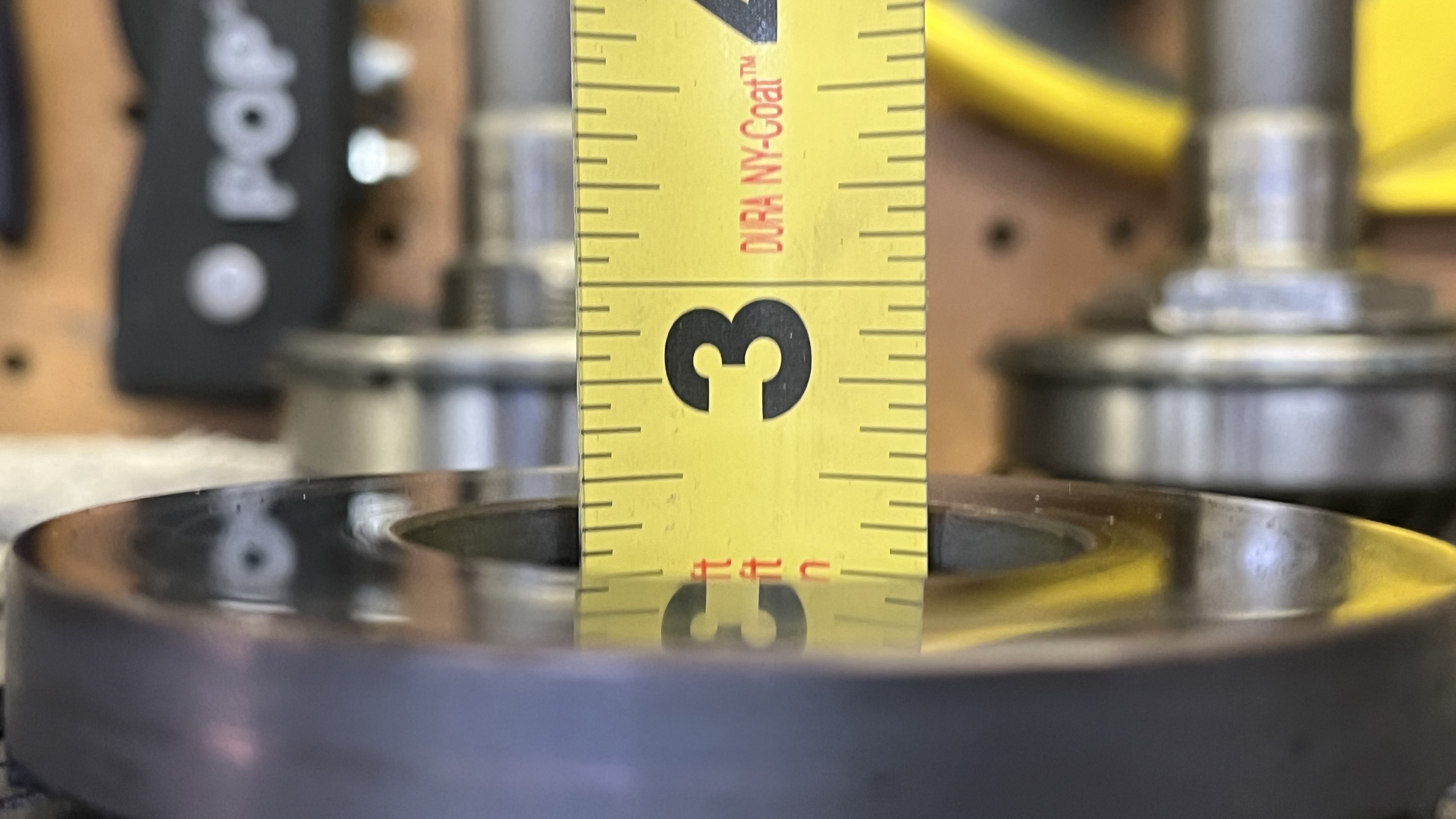

New Borg & Bech HD (HE4562) round pressure plate 2 15/16" bottom to top of pressure plate.
I've used two new ones of these, both pressure plates turn blue 100-200 miles

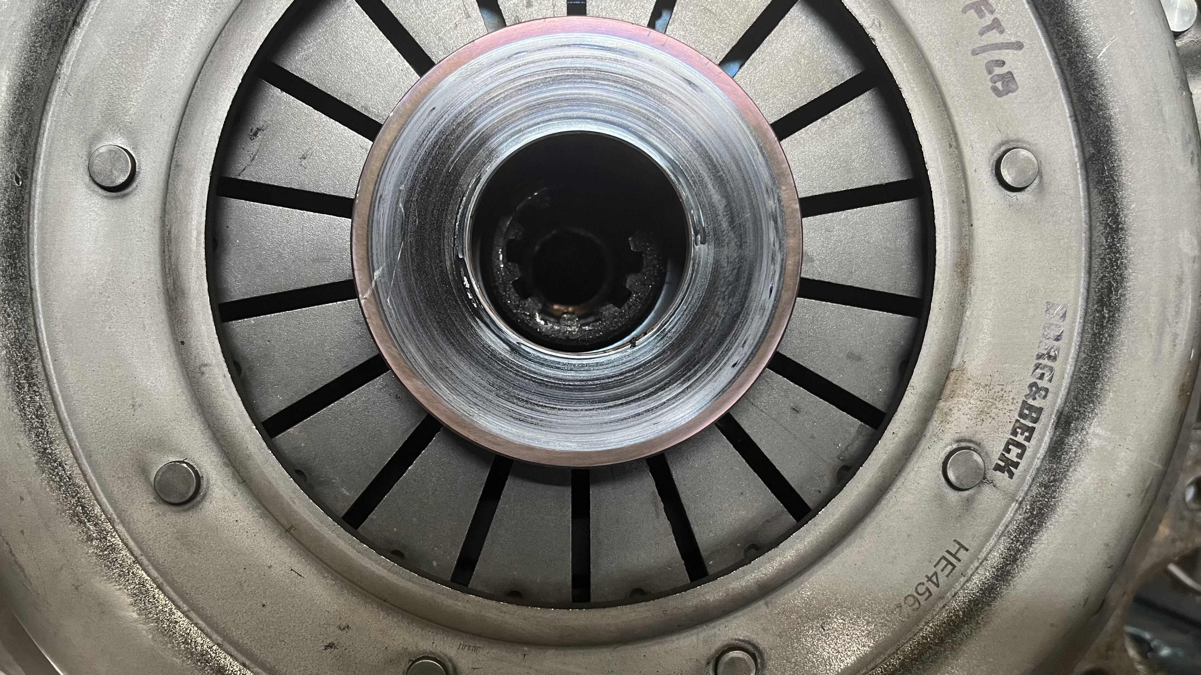

Used Borg & Beck (no model) triangle press plated 3" bottom to top of pressure plate
I just installed this one. Notice the pressure plate is smooth and still natural steel color. I have not turned motor over yet.
I'm trying to figure out why the throw out bearing is turning the pressure plates blue, before I start the engine with this one installed.
Both units are 9 1/2". Both fit on my car. The triangle one looks like the model BJ8 owners uses. Someone mentioned the paint mark should be green. My paint mark is blue. Mentioned blue is Jaguar green is Healey. So I still may not have the correct one?

John, you determined that the pressure plate and thrust bearing dimensions (lengths along the centerline of the driveline) are the same as the parts you took off the car?
Bob, I'm original poster, Roger.
The throw out bearing does center over the thrust plate when making contact. I've attached photos in the previous post of the dimensions of the assembly .

The original pressure plates from B&B for the Jaguar and the big Healey have different part numbers. The Jag unit has a higher spring force to cope with the approximately +100 hp over the Healey. The parts had the B&B part numbers paint stenciled to them during manufacture and the spring painted different colors in a small area. All the new B&B units are dual purpose, they fit both the Healey and the Jag, thus the blue painted spring.
This would have no effect on your problem though, the Jag unit is just stronger. I recently converted my BT7 over to a diaphragm style clutch and I did notice that when released there was some pressure on the fork from the slave. The only thing pushing the slave piston back is the clutch itself, so when the clutch is fully released, there is no additional load to push the slave piston back any further. But for sure it shouldn't be so high to generate heat to turn the plate blue. Online it says steel turns blue at 575 deg F.

I have a used original B&B diaphragm pressure plate (green paint) that I just now measured on the bench . It measures exactly 2.5 inches in height.
From a previous measurement, the height is 2.04 inches when installed.

Hello dezand, the used B&B model I have with the triangle unfortunately has lost it's paint code number, it's stamped Made in England. I'll assume it's an original, but with the blue paint, Jag? Learning as I go. Bought cheap off ebay, who knows how old it is...60s - when?
I bought it to test if the triangle design vs the round release plate and different length fingers may be causing the problem.
My Round B&B 2 5/16"
My Triangle B&B 3"
Yours 2.5"
